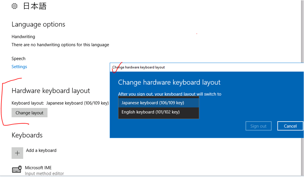

  3. Windows 10 1607 "Change hardware keyboard layout" option under Japanese OS language is missing for standard users.
    Hello All.
    We are facing an issue WRT to Japanese keyboard layout.
    As we know that Microsoft provides only “Microsoft IME keyboard” for “Japanese OS language” and does not provide option to add additional English keyboard (or any other keyboard) for Japanese OS language.
    However Microsoft provides another option to switch the ‘hardware keyboard layout’ between
    Japanese layout (106/109 key) and
    English layout (101/102 key) for Microsoft IME keyboard. But this option is only visible if user is admin on the machine (Screenshot below) and not visible for normal.
    Many users will be working with Japanese OS and will have English keyboard. In such case standard users should be able to see this option to switch between the keyboard layouts:
    Hardware keyboard layout settings to switch b/w 101 and 106 Japanese keyboard is not... c89d0e31-076c-4fdf-942f-96afba2e8dd0.png
    Any way to provide this option to the standard users?
