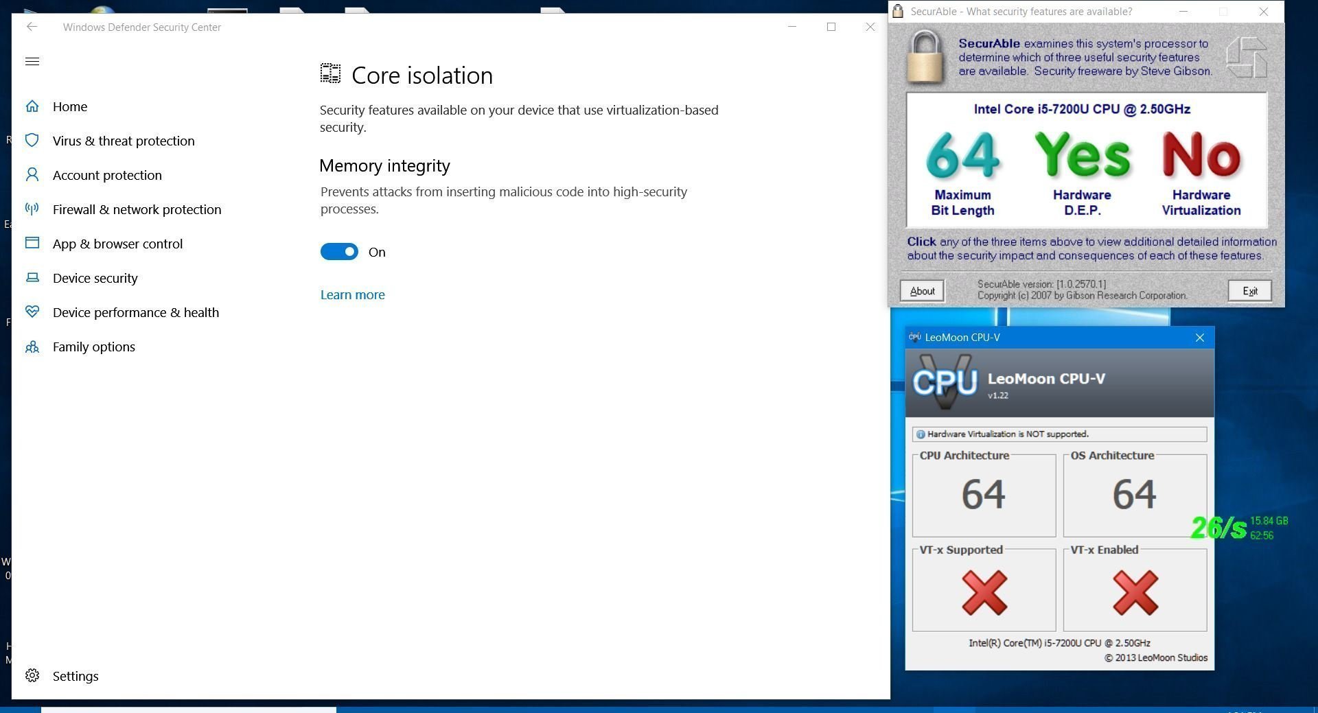

    I have checked 5 times with different modes , I have already esculated the same issue to intel community , but they not working towards this issue.
    I have asus vivobook 15 R542UQ-FDM153
    Bios X542UQ.305
    Activated windows 10 enterprise 64bit v1803 build number 17134.167 (installed on Samsung m.2 )
    Intel i5 7200u 2.5Ghz
    ADATA 8GB ddr4 2400Mhz
    Intel HD graphics 620 with updated 24.20.100.6194 WHQL driver
    Nividia GeForce 940MX 2GB Gddr5 Vram with 398.36 WHQL driver
    Samsung 860 evo 250GB M.2 2280 with updated firmware
    Toshiba 1TB hdd 5400RPM with latest firmware

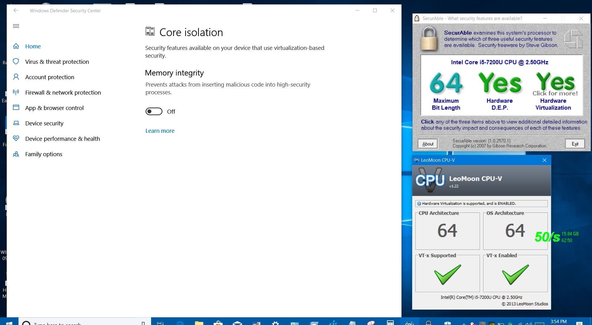

    This issue is not present when memory integrity is disabled or VIRTUALIZATION BASED SECURITY is disabled in registry
    Hardware virtualization wont be available  in I5 7200U  intel processor only , if either... 7d3ef605-cd03-4c20-9c67-a16b50ccd2a4?upload=true.jpg
    Anyone having same issue happened with core isolation memory integrity turned on , this issues happened in windows 10 professional and enterprise and education also
    Hardware virtualization wont be available  in I5 7200U  intel processor only , if either... c5fbe040-9abd-438d-af18-816c3b55394c?upload=true.jpg
    I don't need advice like reset windows 10 , clean installation , sfc scan , dism scanhealth , system restore
    I tried all above methods , I am sure processor is good.
    anyone having enterprise edition with intel VT supported processor , check in ther system and then reply
    virtualization support
    Hi RMTS97, yes that processor does support Virtualization
    Intel:registered: Virtualization Technology (VT-x) - Yes
    Intel:registered: Virtualization Technology for Directed I/O (VT-d) - No
    Full whitesheet for that processor:
    https://ark.intel.com/products/81016/Intel-Core...
    DaveM121, Jul 21, 2018
