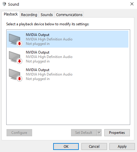

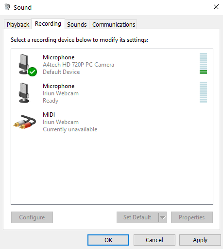

    My playback on my computer doesn't seem to detect my speakers or my headphones although it detects microphone inputs:
    have 2 high definition audio controllers but no sound 368725d1655091710t-high-definition-audio-controller-broken-no-sounds-2.png
    have 2 high definition audio controllers but no sound 368726d1655091710t-high-definition-audio-controller-broken-no-sounds-3.png

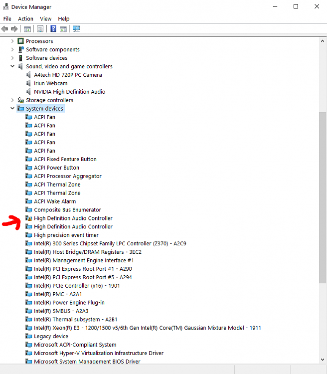

    I checked on my Device Manager and found this:
    have 2 high definition audio controllers but no sound 368727d1655091848t-high-definition-audio-controller-broken-no-sounds-4.png
    I don't know if it's normal for the "High Definition Audio Controller" to be under the "System Devices" dropdown. Still, there are two High Definition Audio Controller hardware and the other one is with a warning sign.

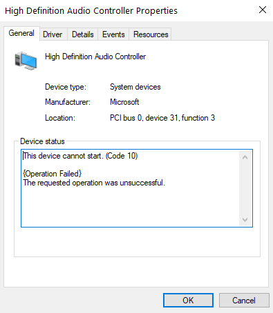

    , this is what It says:
    have 2 high definition audio controllers but no sound 368730d1655092163t-high-definition-audio-controller-broken-no-sounds-6.png
    "This device cannot start. (Code 10)"
    I don't know the meaning of the code but I've been searching for forums regarding this code and still does not fix my problem. I tried uninstalling the High Definition Audio Controller and reinstalling it with a driver I downloaded from Intel website. After installing it, it's still the same.
