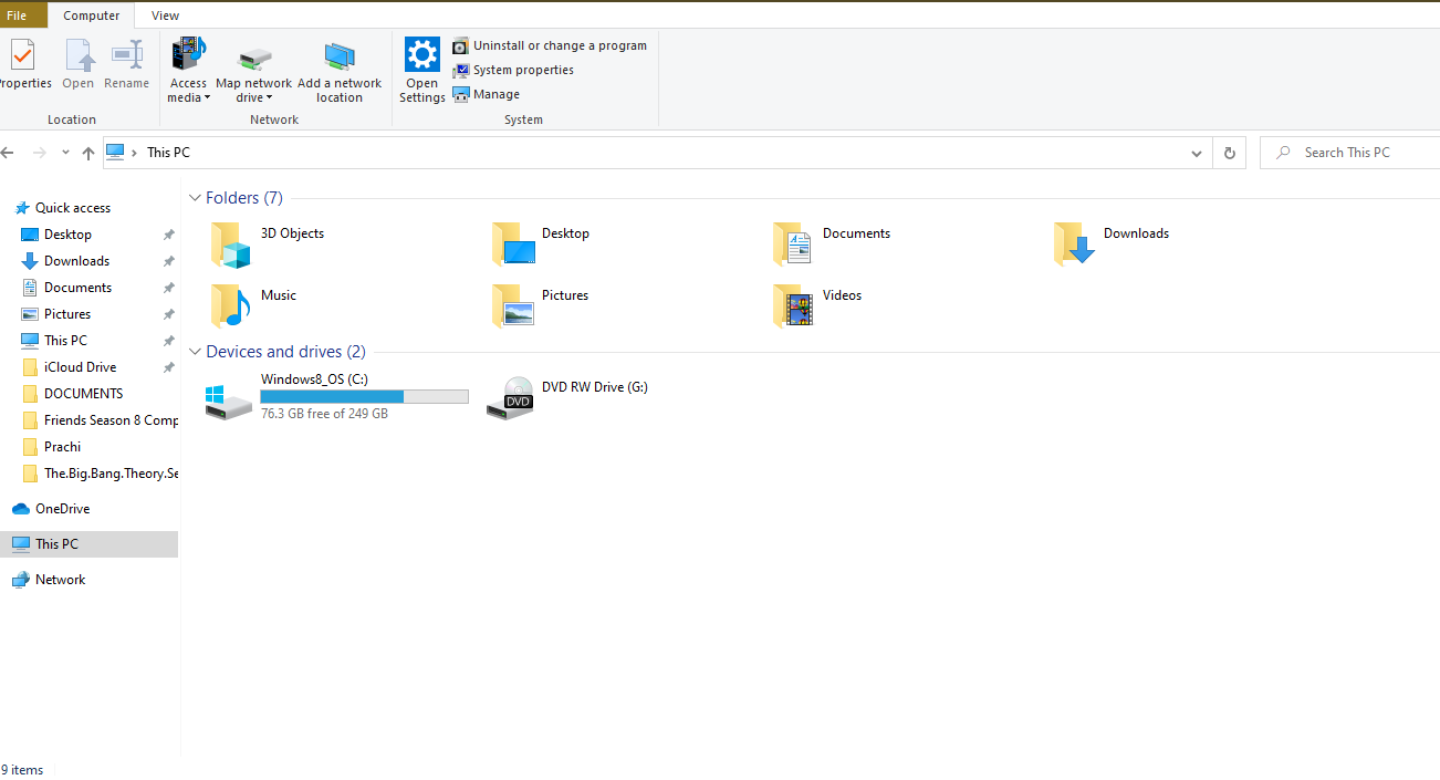

    Hi all,
    I have 1 TB internal hard disk drive on my Lenovo G50 but suddenly today when I opened This PC there was only C drive present and not my other partitions as you can check in the image below:
    HDD partitions not showing in This PC but it is visible as healthy in Disk Management. 9a632aa0-61c7-4707-a25e-0ce54d8fe4b9?upload=true.png

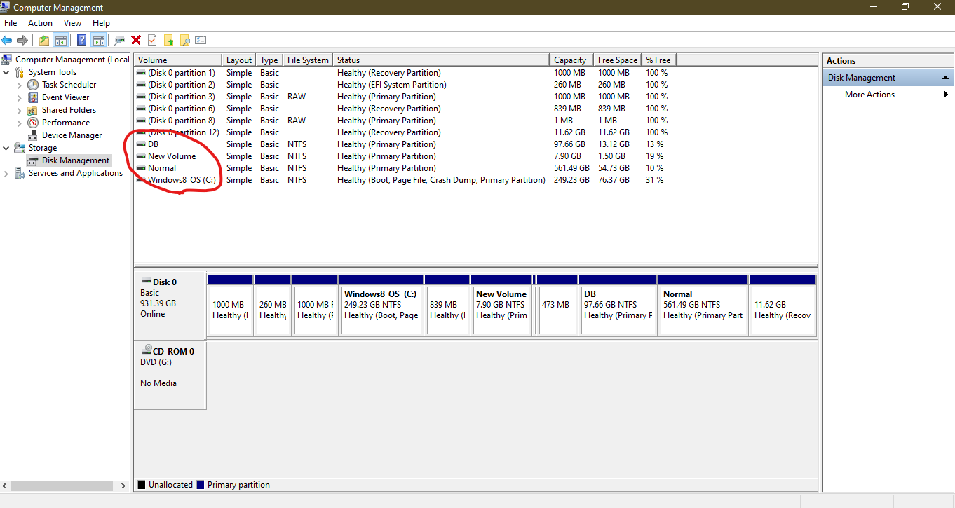

    When I went to check in disk management about the issue the partitions were present there as you can check in the image below:
    HDD partitions not showing in This PC but it is visible as healthy in Disk Management. 57abad95-47a9-433b-ad3b-9c02549515b4?upload=true.png
    Can anyone help me how to resolve this without losing data as there are many important stuffs on that partitions.
    Thanks.

  4. HDD partitions not showing in This PC but it is visible as healthy in Disk Management.
    Disk management console view is not up-to-date
    i dont know how to fix your disk management, but i can fix your partition problems...
    open up Command Prompt with admin rights. (Right click, run as admin)
    enter in
    DISKPART
    list disk
    then find the Disk number for your Raid array... lets call it number 7 ( you can tell what disk is what by the total size)
    type in
    Select Disk 7
    List Partition (will give you a list of all the partitions..)
    Select Partition 1 (im assuming you only have 1 partition on Disk 7) repeat this step if you have more partitions.
    ASSIGN
    that should get the array up and running ready to use.
    EDITED.
    any problems, post back ^^
    Still EDITING *Stick Out Tongue HDD partitions not showing in This PC but it is visible as healthy in Disk Management. :p
    side question, have you tried restarting the PC?
    slyfox2151, Nov 24, 2020
