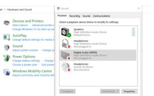

  4. HDMI playback device not showing in Windows 10
    not showing hdmi audio playback option
    Hello Brahmanandarath,
    I would suggest you to follow the steps and check if it helps. First check if “HDMI Output” is selected as the default device.
    • Click Start and select Control Panel.
    • On the right hand side of the screen, under View by: click the drop-down icon and select Large icons.
    • Click Sound.
    • If you do not have the HDMI Output listed under “Playback” tab, right click in the
      playback window and select Show Disabled Device and
      Show Disconnected Device.
    • If the HDMI Output option appears, right-click HDMI Output
      and select Default Device.
    • Now the audio must be playing on HDMI.
    Also try updating the recent HDMI drivers from the manufacturer’s website and check if the issue is resolved.
    Click on the link below for more information on updating the drivers.
    How to: Install and Update Hardware Drivers in Windows 10
    You may also unplug and plug in back the HDMI output and check.
    Hope this information is helpful.
