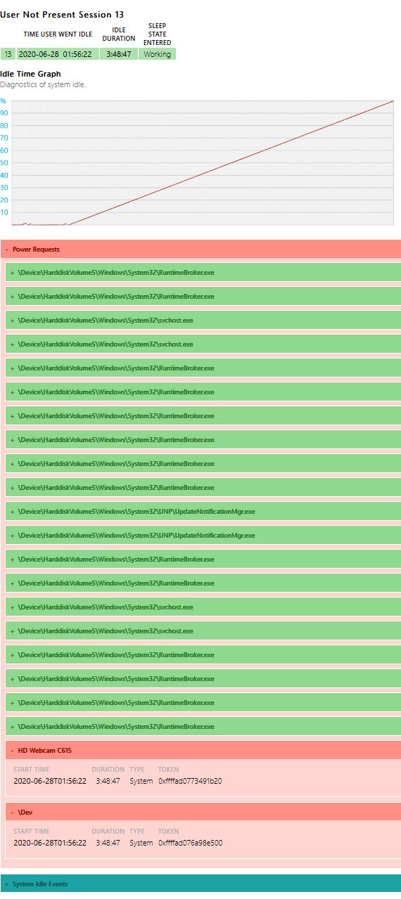

    I cannot quite figure out how to interpret the results. Here is a screen capture from last night (technically early this morning):
    The "TIME USER WENT IDLE", 01:56:22, is correct based on when I left my computer to go to bed. The "IDLE DURATION" implies that something woke my computer up at around 5:45 AM. I live alone and know that no one touched the computer at this time, and from looking at the report the "Power Requests" from "HD Webcam C615" are highlighted in red, along with the /Dev below it. Does that mean the webcam woke my PC up? Did my PC even go to sleep to begin with? The "System Idle Events" at the bottom of the screenshot shows a lot of events with the description "The system idle time was reset because: The system detected user input.", all of which correspond to times I was actually at my computer.

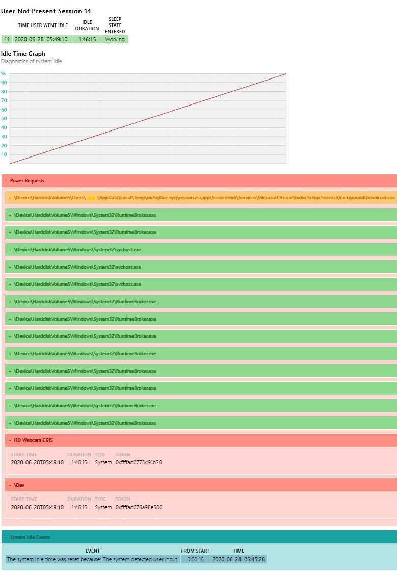

    The next session in the diagnostics file is as follows:
    It appears the computer went idle again after being woken up at the end of the previous session, but was then woken up at around 7:30 AM. Again, no one physically touched the computer at this time. When looking at "Power Requests", I again see "HD Webcam C615" and "\Dev" listed in red, and a VS background service listed in yellow. What is the difference between a red entry and a yellow entry?
    Also the "System Idle Events" says "The system idle time was reset because: The system detected user input." at 05:45:26, but again I live alone and was not awake at that time.
    Can anyone help me interpret these results and figure out how to make Windows ignore the webcam for purposes of putting the PC to sleep, other than manually unplugging and replugging it every time?
