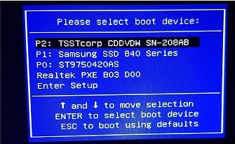

    Hi all.
    So my friend just installed a SATA SSD in his DVD Rom using a caddy. I helped him cloned his Windows 10 from his HDD to SSD already.
    We managed to boot into the SSD using the Windows 10 Advanced Startup by booting from DVD Rom, got a boot device not found error, followed by Boot Manager menu. I can see HDD and SSD option there, selecting SSD on the 2nd row boot successfully.
    However, upon restart, it goes back to HDD again. So we formatted the HDD Windows partitions and restart. But we got automatic repair menu, followed by Advanced Startup which we can boot into SSD by selecting boot from HDD/SSD.
    How do I make sure the laptop will always boot from SSD now?
    Option in BIOS does not seem to carry SSD exactly.
    See the pictures attached: https://imgur.com/a/hEgefFD
