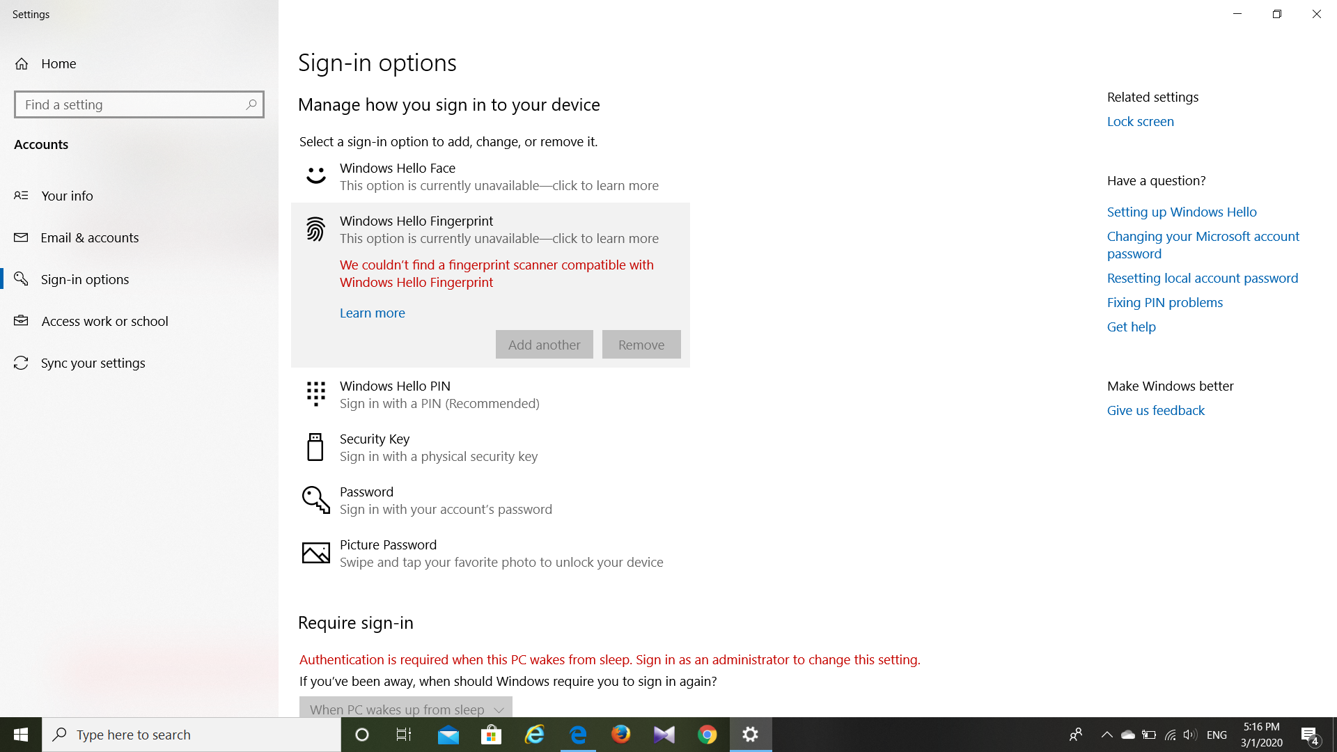

    Hi..excuse me I have problem with my Window hello fingerprint..it is not wprking what should I do?i can not add or remove it
    Hi..excuse me I have problem with my Window hello fingerprint..it is not wprking what... 98ed0c02-6669-4af6-9332-9db8113500c7?upload=true.png

    This is still not working after doing all those steps, please help after the Windows update it stopped working and it says the following : we couldn't find a fingerprint scanner compatible with windows hello fingerprint.
    After taking all the steps you suggested on here it says i have the latest update.
