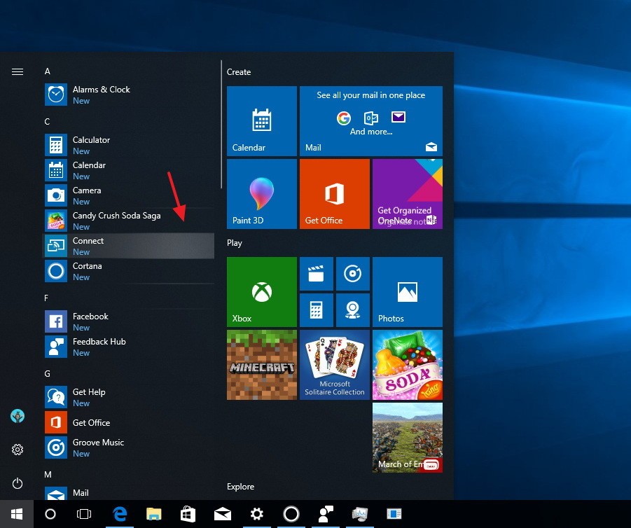

    No Fluent Design Reveal Highlight in Start Menu - Fall Creator's Update
    Transparency is already enabled. I'm seeing the blurs, but reveal highlight is not transparency. This is reveal highlight, what I
    should be seeing:
    Thanks! Hidden Task Revealer :)
