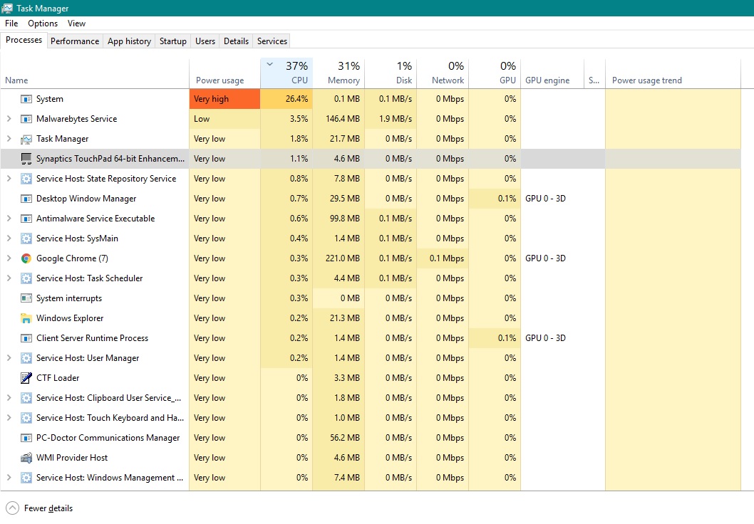

    High CPU and Battery usage after upgrading to SSD, Task Manager System process, Windows 10
    I have a Dell Inspiron with an i5 processor and 8 gb Ram. Recently I swapped my HDD for a new Samsung SSD because the computer would freeze and my disk usage was perpetually at a 100%. Ever since I reinstalled windows, my laptops battery life has gone from an average of 4-5 hours and now finishes in under 2 hours with minimal usage. Each time I open task manager, the "System" task eats up an average of 30% of the CPU and always has either very high or high power usage, which I suspect is the reason for the massive decline in battery power, instead of the normal improvement when someone shifts from an HDD to an SSD. Any help would be much appreciated. Thanks!! High CPU and Battery usage after upgrading to SSD, Task Manager System process, Windows 10 cd6e8c35-85e4-485c-888b-5ffc266ffcda?upload=true.jpg

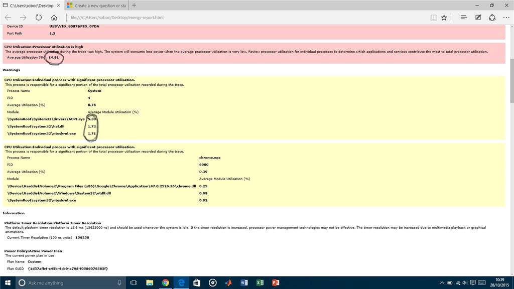

    Hi all
    Ever since I have updated to windows 10 back when it was realised, I have been experiencing high cpu usage by system even if nothing was running. Today I did a power report to check the health of my battery. Report spitted out couple of warning which relate
    to CPU usage. Ill insert a screenshot of this so you can see what I mean. Because of that constant CPU usage my leptop battery is not very good and CPU area gets really hot in normal tasks, I'm talking about 60-65 deg C compared to around 45-50 on windows
    8.1. If it helps my laptopop is Samsung NP700z5C s01uk with SSD upgrade.
    High CPU and Battery usage after upgrading to SSD, Task Manager System process, Windows 10 57a9e7df-a058-43c9-9a28-81225cd404b3.jpg
    rafalsoboczynski, Feb 7, 2019
