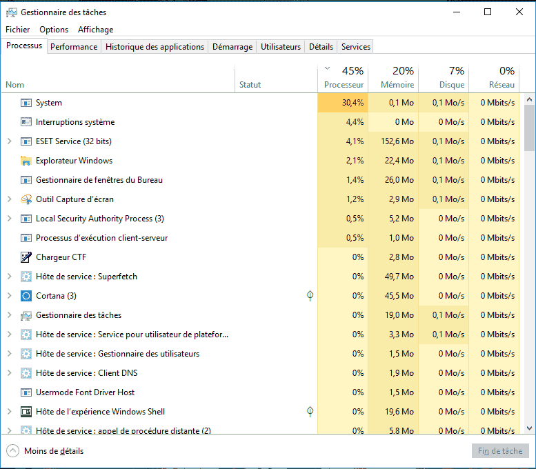

    High CPU usage by ACPI.sys ("system" process)
    So here is my problem : in the task manager, the "system" process sometimes takes ~30% CPU (when it should take between 1 and 6% at most). This happens every time I start my computer after completly shutting it down. Putting it to sleep and wake it temporarily solves the problem, but it happens again at the next start, or it can also come back at random which is really problematic when i'm doing other CPU-hungry activities.

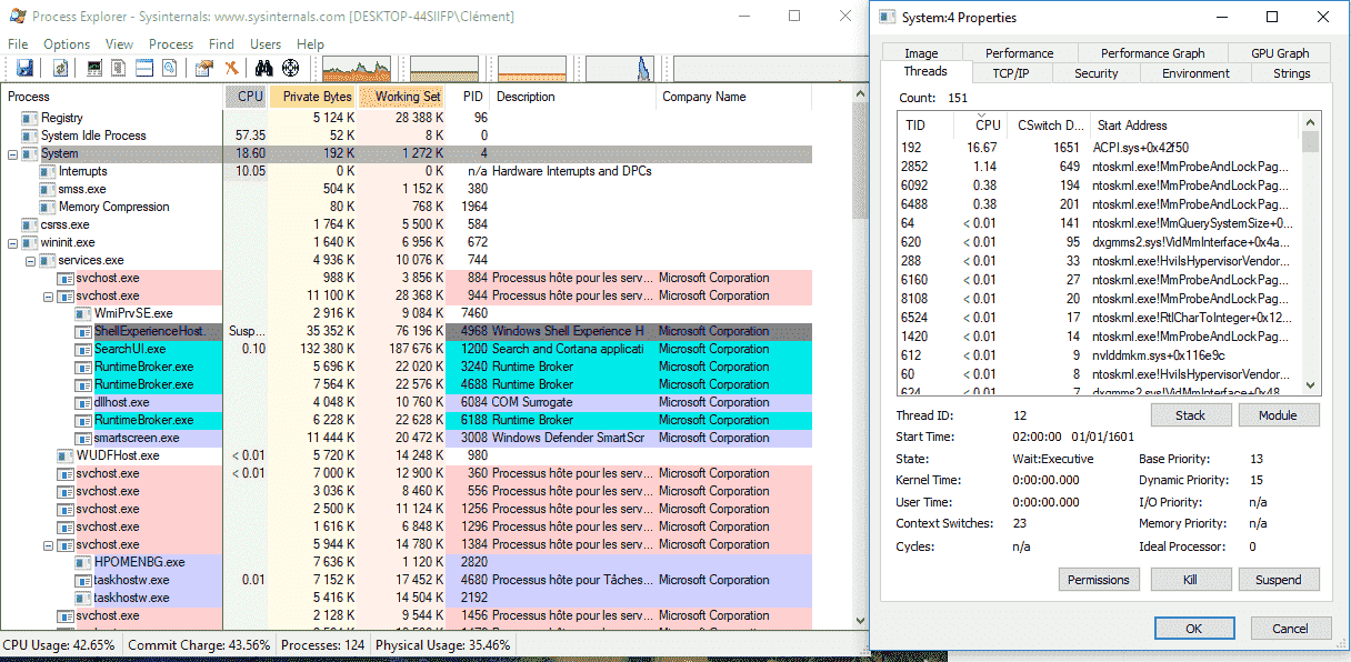

    First, i investigated what makes the system process take so much CPU with the Windows process explorer, here are the results :
    High CPU usage by ACPI.sys ("system" process) 17bb25f0-0907-4a4b-91e5-833b6739f4cd?upload=true.png

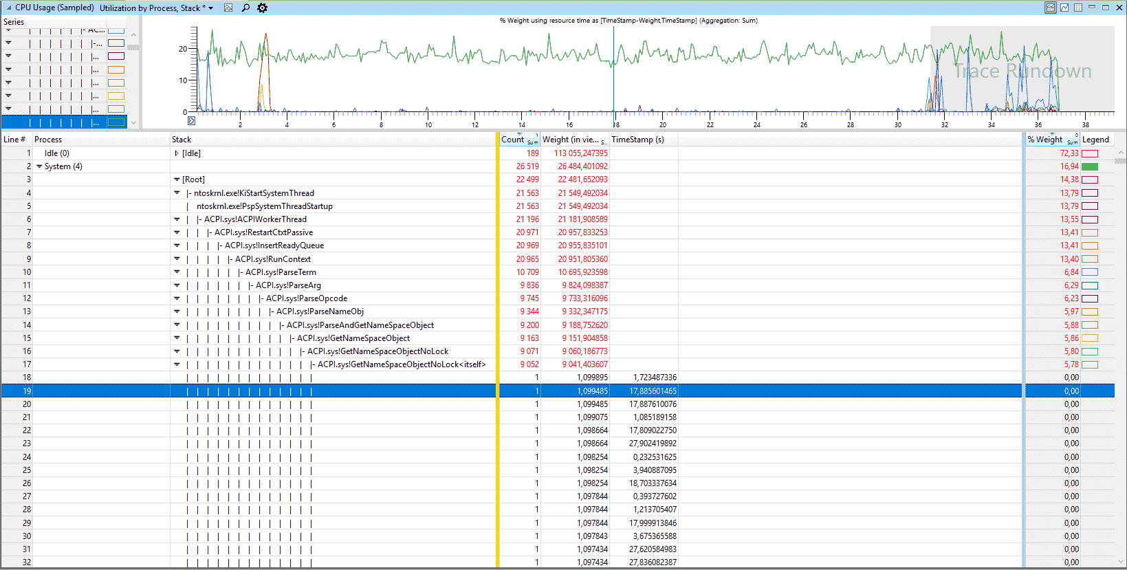

    I also saw a topic where people ran Windows Performance Recorder, so I did too to see if we had the same issue (we hadn't) :
    High CPU usage by ACPI.sys ("system" process) deca0158-1d2e-4874-bea1-187adf050901?upload=true.png
    (on a 30sec recording)
