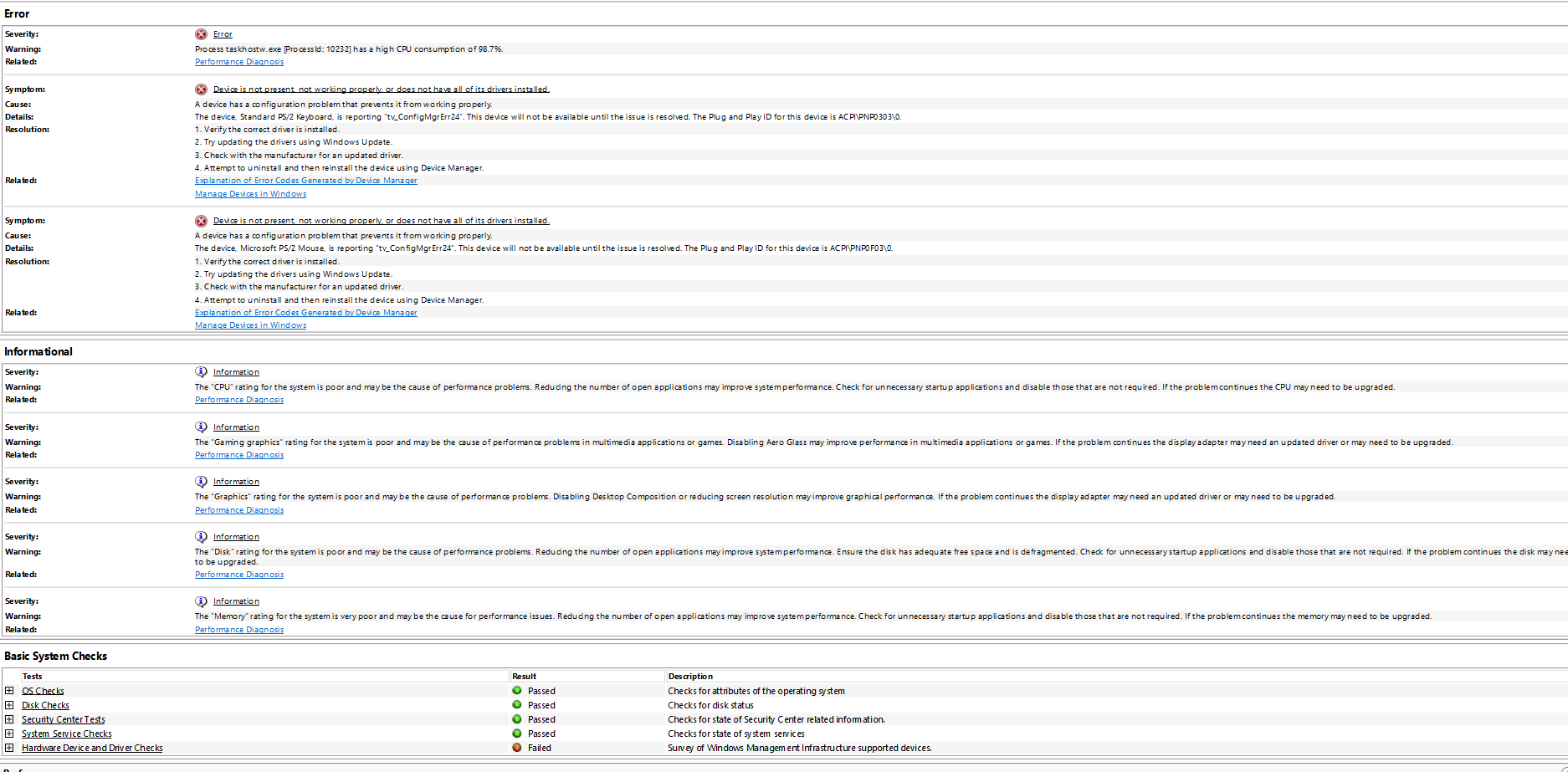

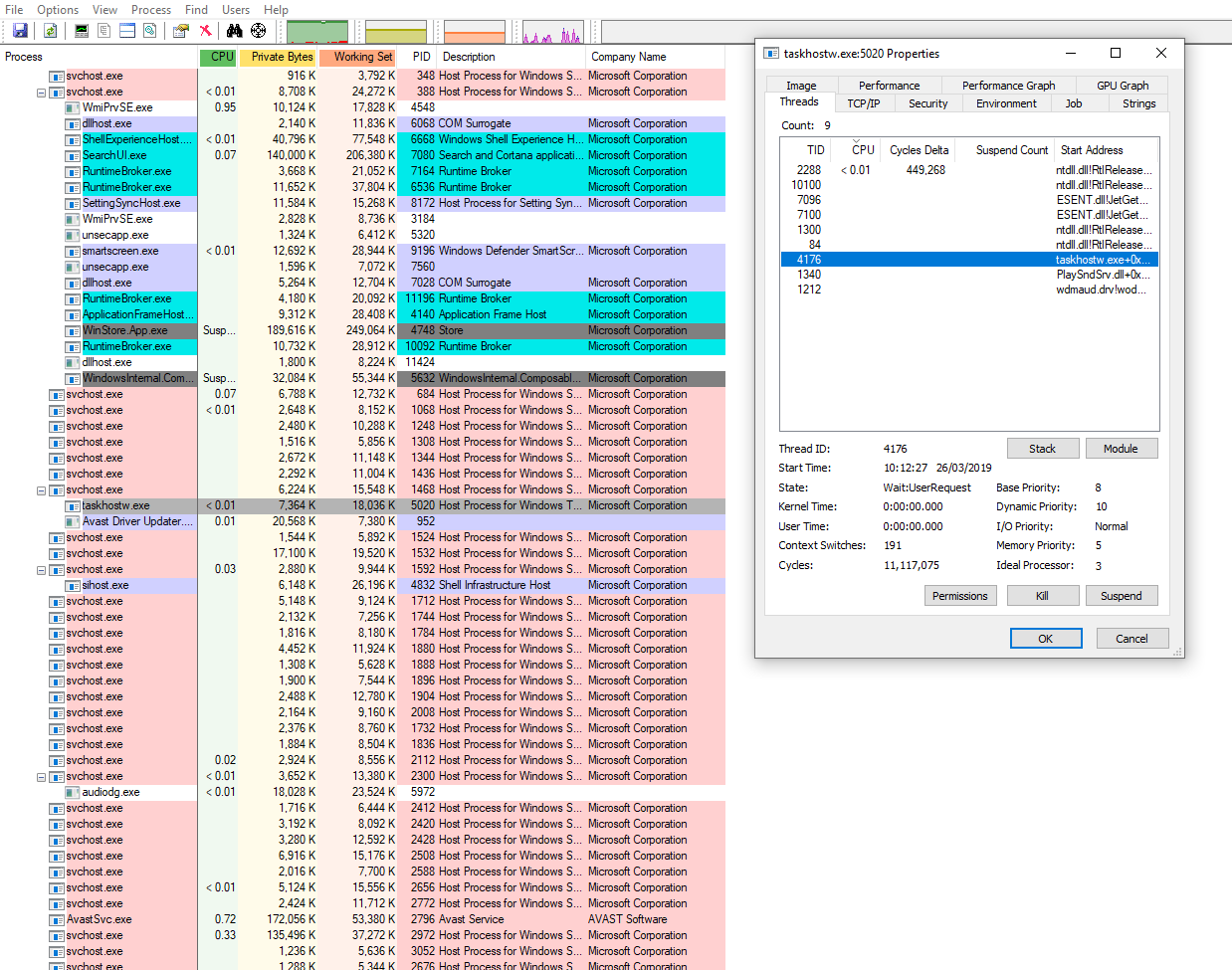

    Over the past few months, I have been getting constant Windows 10 lockups. Even when my pc is idle, I will find that everything will become unresponsive for about 5 - 10 seconds and the Hard drive light turns solid red.
    I look at Taskmanager and it says that my PC is using 100% CPU but does not show which process is causing the issue, disk and memory are all normal.
    I have recently performed a clean install of Windows 10, removed everything and started again. Everything was okay for a little while but the issue started again and I have no clue what could be causing it.
    All drivers updated, I have tried to disable Runtime Broker to no avail. Games lockup.
    I have run Perfmon /report and it shows that Taskhostw.exe is using 98% of my CPU. I have checked taskhost on process explorer and comes up with a few crazy looking threads.
    My virus scanner comes back as all clear and I have had a pc shop do a diagnostic and everything seems fine internally, they suggested reinstalling but made no difference.
    I will try to attach a few Images of the things I have found #.
    If anybody has any ideas as to what might be causing these lockups, I would be extremely grateful.
