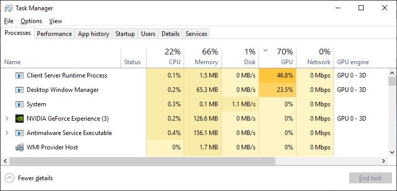

    High GPU usage by "csrss.exe" and "dwm.exe" even when idle.
    I have been having this problem for a very long time. I have searched on the web and many people seem to have had the same problem, but no definitive solution posted anywhere. So I open the case again:
    My problem is, windows processes Client Server Runtime Process (csrss.exe) and Desktop Window Manager (dwm.exe) very often start using the integrated GPU card (GPU 0 - 3D). This causes the laptop fans to go crazy, there is stuttering on videos and on my mouse and my work (which is resource intensive) is affected.
    This issue can happen at any time, at any level of use of the computer. That is, it can happen as soon as I boot up, when working, when watching netflix, etc. It is indiscriminate and over the past year I have never seen any correlation to specific usage. The frequency is very high, and when it starts it keeps going for prolonged periods of time to the extent that I would say almost half the time I am on my laptop, this issue happens.
    In the past I have tried:
    • Clean install of Windows
    • Re-installing the integrated graphics card's drivers
    • Re-installing dedicated graphics card's drivers (GTX 1050)
    • Disabled all fancy Aero settings
    But nothing fixed it.
    Below is a screenshot of what the task manager usually shows during these episodes.
    High GPU usage by "csrss.exe" and "dwm.exe" even when idle. 842bccf7-a4fe-468c-b066-eb5bfe223eff?upload=true.png

  2. dalchina Win User
    csrss and dwm processes High GPU Usage causing stutterings
    High GPU usage - csrss.exe - Resolved Malware Removal Logs - Malwarebytes Forums
    This example backs up what @Faith said above. So do do that first.
    If clean:
    Please have a look at your Update History. Is there anything there- including drivers at the bottom- that was updated just before this started happening?
    Have you made any changes- installed anything- that might be responsible?
    Do you have any System Restore points created before this started happening?
    Or disk images? (I constantly urge users to use this routinely, as do many here - e.g. Macrium Reflect (free) + external storage for disk image sets)
    Desktop Window Manager - Microsoft Community
    - a long thread- see if there's anything helpful there.
    Sudden high GPU usage by client server runtime process makes huge fps - Microsoft Community
    - try a clean boot. Is there any change?
    note forum rules say 'useless one liners' and thread bumping are not allowed. I can understand your enthusiasm to resolve this.
    dalchina, Apr 21, 2019
