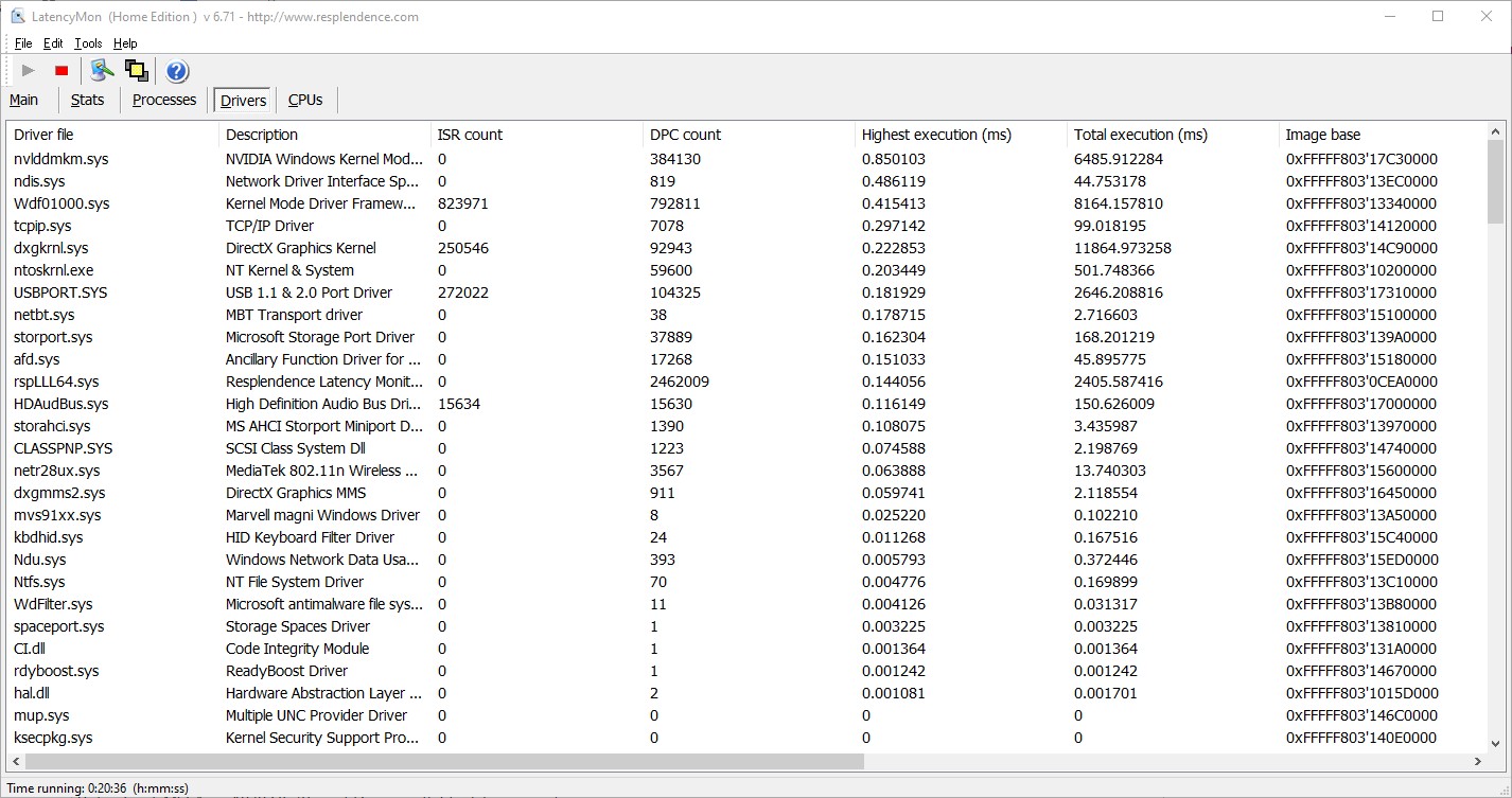

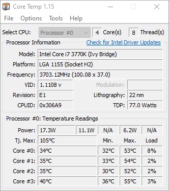

    Not even 100% sure what's going on here. This started all recently had no issues with 1903 up until recently. Even done a clean install and the problems still exist. I did have an overclock but had no issues for months up until recently now running stock. Temps are great. I seem to be able to play games fine there is no issue there. The mouse is the problem from what I see so far. Though I have seen apps all of a sudden crash with no explanation with Windows Event Viewer. I have had the CPU Core set to 1.17v's in the past no issue what so ever but now programs even crash at that. So I've tried 1.20 and same issue. Now have it at 1.225 haven't seen a problem yet that i'm aware of. But stuttering with the mouse, web page scrolling stops and goes, scrolling in some apps has a weird effect and isn't smooth.
    I've heard bluetooth has issues right now so I have removed it from the computer. Heard Realtek has issues with current Nvidia drivers and to disable Nvidia Audio which I have done. I'm currently using the back ports of the USB 2.0 cause I though there was issues with that. I thought there was problems with my USB 3.0 hub by Orico so I removed it. I've reinstalled tons of a drivers even back to their old ones to see if that would solve problems and it hasn't. I've used an air compressor to clean my computer out still wouldn't solve the issue. I have the latest bios setup for this board and also now have all the latest drivers installed for other hardware same issue.

    CPU: Intel 3770k currently running stock 3.9ghz (was OC'd 4.4ghz Turbo with 1.17 to 1.225v's)

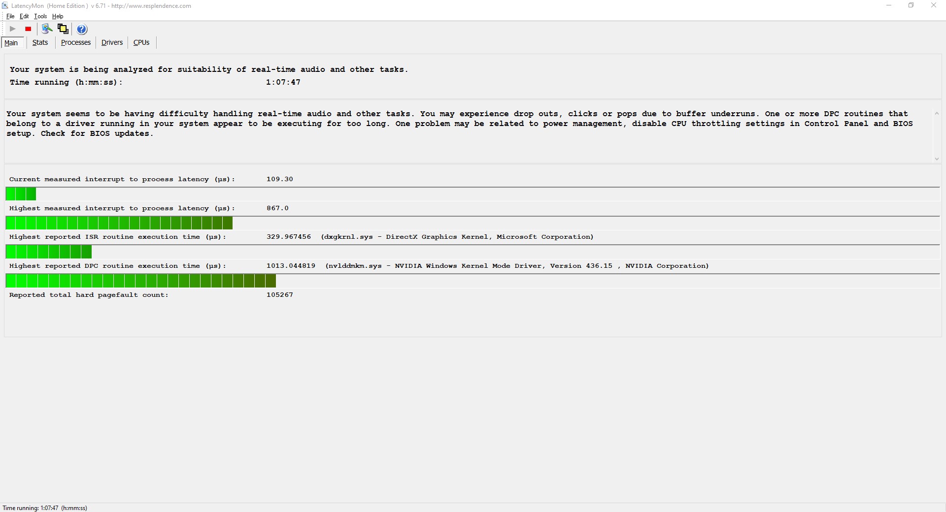

    Latencymon says issues I've seen it get higher
    High Latency PC is Sluggish, lags, stutters fb084e90-8c3e-4925-85eb-9952cf974d60?upload=true.jpg
    High Latency PC is Sluggish, lags, stutters c92857f2-a021-4f7c-b867-9c77cc9b8d76?upload=true.jpg
    High Latency PC is Sluggish, lags, stutters 0bc3386d-9343-4ea1-997a-942c20552731?upload=true.jpg

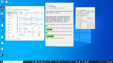

    Here is a video and gif though it can get quite bad sometimes the mouse will drag slow. For now you can see the mouse just sudden pause.
    https://youtu.be/1RPZP6CPyEc
    High Latency PC is Sluggish, lags, stutters b7be9984-05b0-4607-9251-e28dced4466d?upload=true.gif
