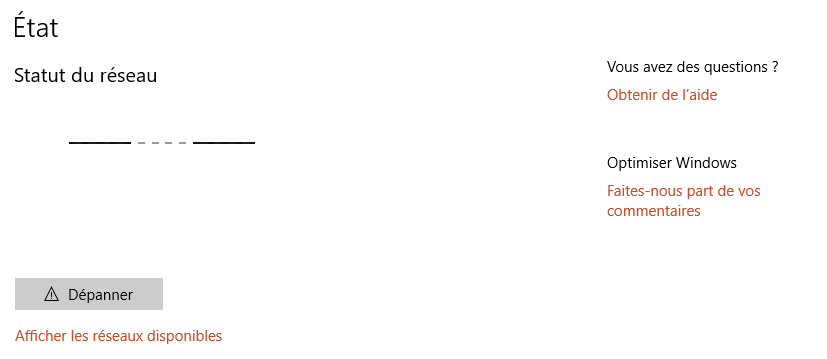

    I have the same problem as others but I coudn't find any working solutions in the one proposed by the helpdesk.
    So I don't have anymore a wifi or network icon. and when I go the my network I have this :
    horizontal dashed line in windows 10 network status! c89c3489-ccd9-4190-a444-83bc88a04615?upload=true.png
    When I go to my network adapters, I've tried to deactivate/activate wifi, réinstall drivers, restart... it stays activate but with no network.
    Weird thing : if I use "Speccy" a program from piriform, He finds the card and the wifi networks. If I deactivate my card, i doesnt...
    So for me. It's not an hardware problem the green leds on the wifi card are on and it's not a router problem : my other computer/smartphones have no problem.
    What can I do?

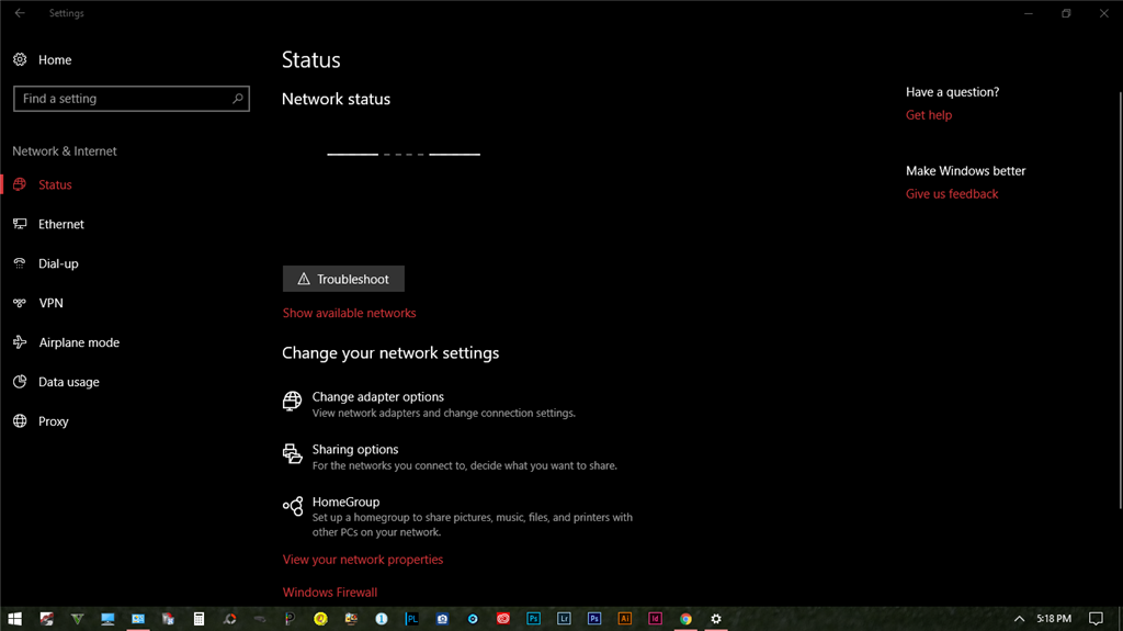

  2. Wifi status appears as a dashed line - cannot find networks (though my computer connects to remembered networks and has internet)
    Horizontal dashed line in Windows 10 network status!
    We have experienced this behaviour also on some of our company laptops last week.
    This behaviour can cause Office 365 to not find the license server anymore, if you take a look on your office account in for example word it will say: No internet connection.
    However you are still able to browse the web and able to ping several webservices.
    Although a restore can help with this issue, this is not the root cause.
    In our case a restore did not help, neither did a firmware, bios and driver update for the network adapters.
    We deinstalled several software packages but this was also not helpful.
    The solution was pretty simple:
    The network list service was disabled in services, this was most likely the case after a windows update or software that has been installed (for example a VPN software solution)
    We suspect it to be because of a Windows update since we had this issue on several laptops in different countries all within a certain time frame (no software was installed during that timeframe, only windows updates)
    Once we set the network list service back to manual startup and started the service the horizontal dashed line disappeared and
    we were able to fully function again.

  3. WIFI SETTINGS CANNOT BE FOUND ANYWHERE IN WINDOWS. NETWORK STATUS SHOWS A HORIZONTAL DASHED LINE
    Recently i lost all ways to turn on wifi in my windows 10. I can't even find the wifi icon in the task bar and also in notification bar . Also, In settings there is no wifi section. And in network status, a long dashed horizontal line is shown. I really
    face an immense difficulty as i cannot access the home and office wifi. Now i need to carry the usb cable around inorder to usb tether the cellular 4g connection. Please help me. I did many research in this matter and couldn't find anything usefull yet. This
    is how everything looks like.
