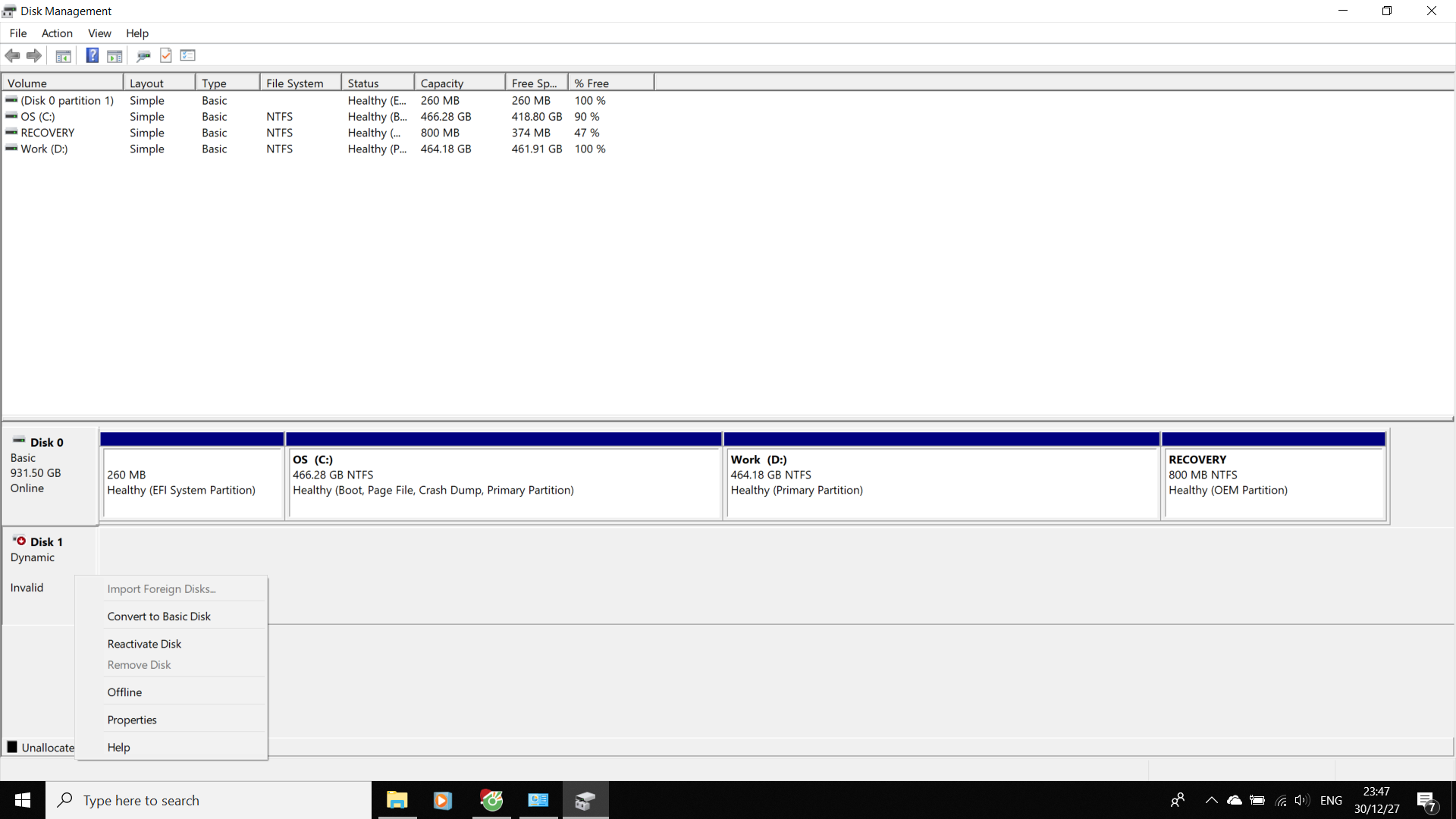

    I've just bought an Asus F650UD laptop, and have been trying to connect my currently in-use hard drive to it via a dock that hooks up with one of the SATA ports. The drive does get recognized and is displayed in the Safely Remove Hardware list, however it
    doesn't appear in This PC, and cannot be accessed from anywhere. Opening up Disk Management reveals the following screen:
    As you can see, the hotswap drive I've been trying to connect is labeled Disk 1 here. While it was recognized by Safely Remove Hardware, here it's shown as Invalid and remains uninteractable. Opting to reactivate the disk would return an error message stating
    that invalid disks are not allowed that operation. So I took a step further and checked the status of the SATA ports in the system BIOS, and the only option shown with it was AHCI - the system default, with no alternatives whatsoever, nothing that says "Enable
    hotswap/hotplug". So what exactly must I do to make this drive accessible? I've tried out all the methods I know above, and none of them have worked.
