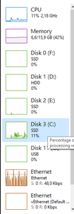

  1. How can I change disk order? My C: drive is for someone reason not first which is confusing
    /u/_Kristian_, Apr 13, 2021
  2. Changing the drive that my Local Disk (CHow can I change disk order? My C: drive is for someone reason not first which is confusing :) is on. Or uninstalling windows to reinstall to the correct drive.

  3. C: drive not on on disk 0 but on DIsk 2..Is that a problem?
    Pretty sure the drive order is down to the SATA/ AHCI driver while in Windows regardless of BIOS/UEFI reporting (and at least on UEFI systems), my drive order was similar to yours, SSD was disk 0, HDD was disk 1, NVME was disk 3 (with Windows, and as boot drive), but installing the Intel RST driver for SATA/AHCI controller and the Intel NVME driver the order changed to reflect the physical order of disk connections.
    So now it looks like this;
    How can I change disk order? My C: drive is for someone reason not first which is confusing [​IMG]
    This is also reflected in Diskpart (run in admin command);
    Currently my USB boot disks are being re-written so unsure how the drive order would appear listed from outside windows.
    Pejole2165, Apr 13, 2021
