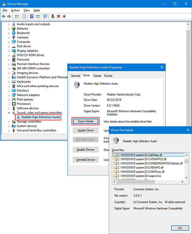

    To determine which driver you need you must follow these steps:
    1. Right click on the Start Menu and select Device Manager or in Search type devmgmt to open Device Manager.
    2. Navigate to “Sound, video and game controllers” and open “Realtek High Definition Audio”
    3. Select the Driver tab and click “Details”
    4. In Details search for any of the "special" files, for your specific driver, according to the list below.
    The image below is an example of Realtek driver with Conexant (CXAPO) Integration and the HDA driver type needed to update the Audio device, according to the "special" files lists below is FF04. You must have something similar, for the same or other integration:
    How can I determine the type of audio driver windows uses for a device? 245834d1567684980t-determine-hda-realtek-driver-needed-your-audio-driver_details.png

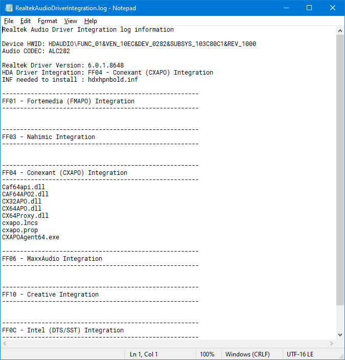

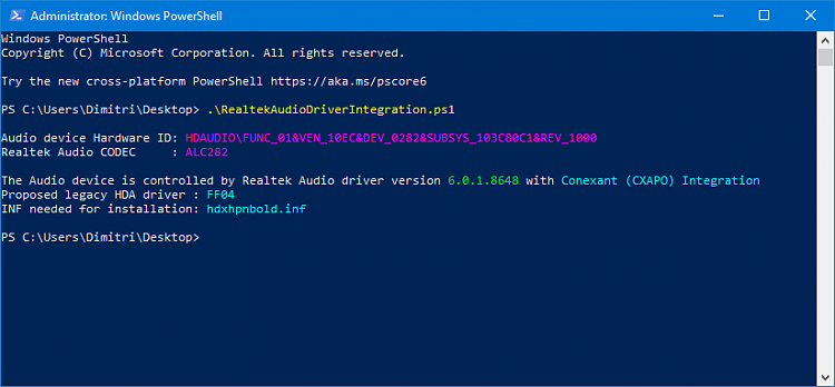

    When the script is completed, it will give you the driver type (integration) you currently have installed for your Audio device and will propose which HDA driver type you need to use for updating your Realtek driver.
    It will also create a log file named RealtekAudioDriverIntegration.log, on your Desktop, which you can examine or post in this thread to verify that the results produced are accurate.
    Example of script output:
    How can I determine the type of audio driver windows uses for a device? 262808d1578828733t-determine-hda-realtek-driver-needed-your-audio-script_output.png
    Example of the log file, the script creates on the user's Desktop:
    How can I determine the type of audio driver windows uses for a device? 262809d1578828733t-determine-hda-realtek-driver-needed-your-audio-script_log.png

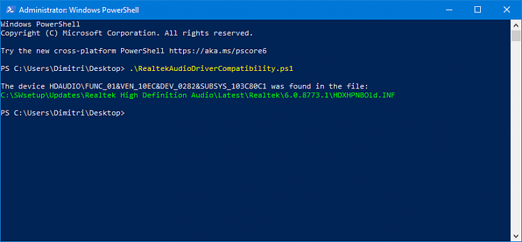

    Option Three [/i] Check your Audio device compatibility with an HDA Realtek driver, with PowerShell
    To check if a downloaded HDA Realtek driver is compatible with your audio device (i.e. if the audio device Hardware ID is included in the ".inf" files of the Realtek driver), follow the instructions given above on how to run a PowerShell script and run the following script.
    RealtekAudioDriverCompatibility.ps1
    Download

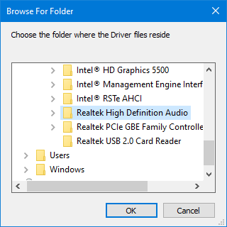

    The script will open a folder picker window and ask you to provide the location where the downloaded Realtek driver has been expanded/extracted.
    How can I determine the type of audio driver windows uses for a device? 245854d1567688821t-determine-hda-realtek-driver-needed-your-audio-folderpicker.png
    It will then check if the driver’s ".inf" files include your system’s Realtek audio device Hardware ID and give you the complete name of the ".inf" file that contains your audio Hardware ID.
    How can I determine the type of audio driver windows uses for a device? 245855d1567688839t-determine-hda-realtek-driver-needed-your-audio-script2_output.png
