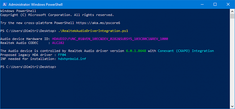

    Option Two [/i] Detect Realtek HDA driver Automatically, with PowerShell
    To automatically detect the type of your Realtek HDA driver, you can use the following PowerShell script.
    RealtekAudioDriverIntegration.ps1
    Download
    1. Download the script, save it on your Desktop (or any other convenient folder) and unblock it.
    2. Open PowerShell as Administrator and run the script.
    Release Notes of version 1.3 (11-Jan-2020)
    • Fixed detection of multiple integrations
    • Added INF file required for installation
    To run the script you must first make a note of the folder where the script has been saved. Once you know where it is located you can run it in any of the following two ways:
    In PowerShell, either navigate to the folder where the script is located and run it from there. e.g. if it is saved in the Downloads folder you type the following two commands:
    cd $env:USERPROFILE\Downloads
    .\RealtekAudioDriverIntegration.ps1
    Or
    If you want to run the script from your current location in PowerShell and the script is saved in your Downloads folder, type the following command:
    & $env:USERPROFILE\Downloads\RealtekAudioDriverIntegration.ps1
    If you haven't already changed the PowerShell ExecutionPolicy to allow running scripts, you need to do it. So before running the script (or any other script, from a source you trust), run the following command to allow the script to run in the current PowerShell session.
    Set-ExecutionPolicy Bypass -Scope Process
    Remember that closing the PowerShell window your ExecutionPolicy returns to its defaults, for every new PowerShell window (session).

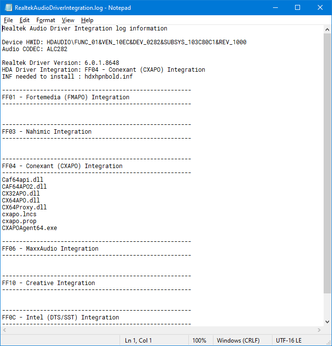

    When the script is completed, it will give you the driver type (integration) you currently have installed for your Audio device and will propose which HDA driver type you need to use for updating your Realtek driver.
    It will also create a log file named RealtekAudioDriverIntegration.log, on your Desktop, which you can examine or post in this thread to verify that the results produced are accurate.
    Example of script output:
    How can I determine the type of audio driver windows uses for a device? 262808d1578828733t-determine-hda-realtek-driver-needed-your-audio-script_output.png
    Example of the log file, the script creates on the user's Desktop:
    How can I determine the type of audio driver windows uses for a device? 262809d1578828733t-determine-hda-realtek-driver-needed-your-audio-script_log.png
    The script has been tested and runs well, but like every piece of software, the more people run it and give feedback the better it will become.
    It will not harm your system, as it doesn’t make any changes to anything and if it doesn’t provide accurate results, you can post the contents of the log file it creates on your desktop, to find the reason it failed.
    That's it. You now know, which driver type you need to update your Audio. Find the appropriate one and update to the latest version!

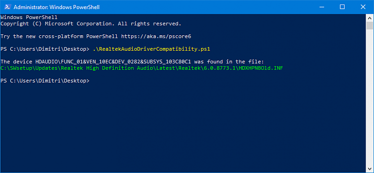

    Option Three [/i] Check your Audio device compatibility with an HDA Realtek driver, with PowerShell
    To check if a downloaded HDA Realtek driver is compatible with your audio device (i.e. if the audio device Hardware ID is included in the ".inf" files of the Realtek driver), follow the instructions given above on how to run a PowerShell script and run the following script.
    RealtekAudioDriverCompatibility.ps1
    Download

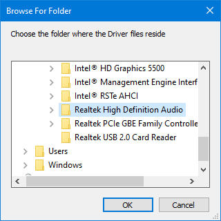

    The script will open a folder picker window and ask you to provide the location where the downloaded Realtek driver has been expanded/extracted.
    How can I determine the type of audio driver windows uses for a device? 245854d1567688821t-determine-hda-realtek-driver-needed-your-audio-folderpicker.png
    It will then check if the driver’s ".inf" files include your system’s Realtek audio device Hardware ID and give you the complete name of the ".inf" file that contains your audio Hardware ID.
    How can I determine the type of audio driver windows uses for a device? 245855d1567688839t-determine-hda-realtek-driver-needed-your-audio-script2_output.png
