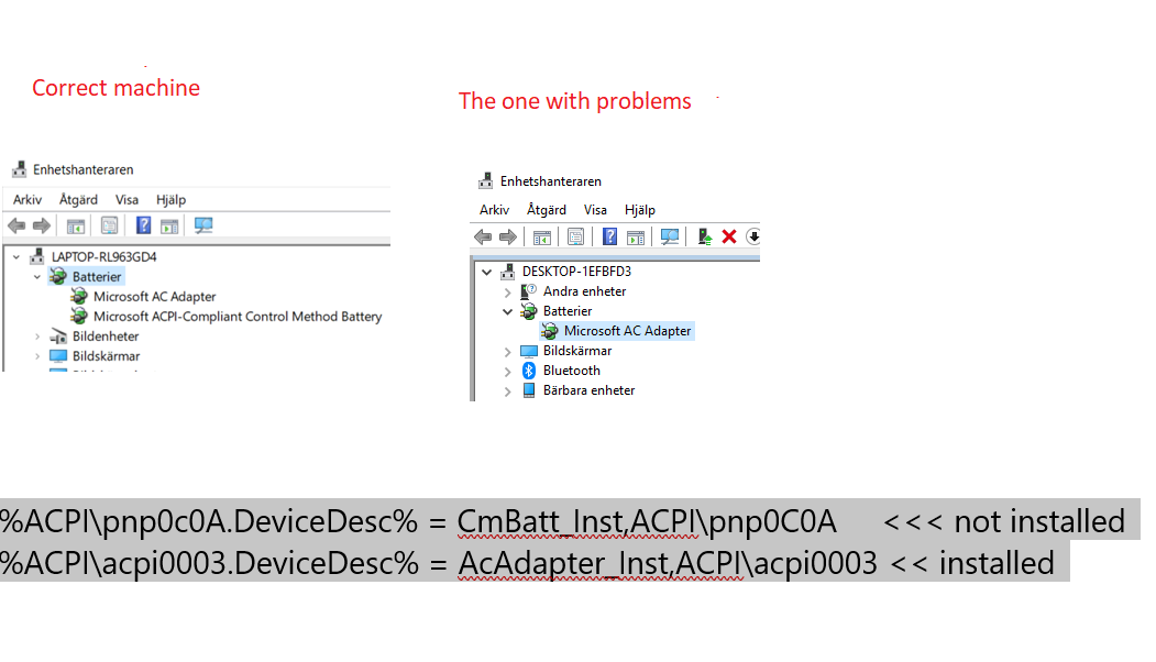

    The machine is a Lamina T-1010B.Nord running Windows 10 (32 bit) version1809
    • I have made a complete scratch & install of Win10, for several reasons. That job cleared the machine and partitioned the disc.
    • There is no Battery icon visible so, I don’t know whether it’s charging or not. In a simple test it ran for about 20 minutes without being connected to a power adapter. That gives a little hope, but still frustrating not to know the level of the battery.
    • There is a Speaker icon, but it says “There is no sound unit installed”
    • There may be some other issues that I haven’t observed yet.
    • I have after some time managed to install some of the missing drivers, by downloading them from Internet. Some of them are in place but not functioning properly.
    • Looking into a specific .inf file for a battery installation I see it should install a driver package and two drivers. The package and one driver came into place but not the second driver.
    • From time to time I have made the battery icon appear just to say: ”No battery found”
    • I have tried every suggestion given on this issue, but none has worked.
    • I have put questions to the Swedish Microsoft community, been mailing/chatting/speaking with the MS support, been googling but …..
    • My current theory is that drivers cannot be properly installed because there isn´t any firmware to connect the drivers to. Swept away at the time of installation, I guess.
    • The manufacturer tells me the unit is to old (?) to be dealt with from their side, so I must find an approach of my own to solve the problem
    Using Device manager, I find:
    1/ The only unit connected to Battery is Microsoft AC Adapter (HW unit id ACPI\ACPI0003) but no Microsoft ACPI-Compliant Control Method Battery. (HWACPI\PNP0C0A)
    2/ There is no subsystem Microsoft ACPI-Compliant Embedded Controller ( ACPI\PNP0C09). Can only find subsystem Microsoft ACPI-Compliant System (ACPI_HAL\PNP0C08).
    What can I do more to reach a solution? Can anyone help me?
    Attached is a picture describing some of the problem
    Best regards
    Janne
