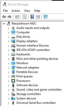

  2. beau Win User
    Can't Find WebCam Device in Device Manager
    In Win7 I'd do Device Manager > Imaging Devices > USB 2.0 PC Camera to find my USB WebCam and activate it and de-activate the monitor's built-in camera.
    But in Win10 Device Manager has no listing for Imaging Devices.
    How can I use a phone as a webcam and have it show up under cameras in device manager... 84208d1485967992t-cant-find-webcam-device-device-manager-device-manager.jpg
    Where in Win10 can I enable and disable webcams?
    beau, Nov 7, 2024
