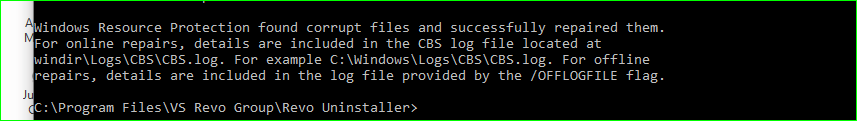

    how do i find offlogfile flag
    how do i find how do i find offlogfile flag b3396cf6-5a15-4045-a29d-93f124490a46?upload=true.png
    TIMMY 067, Mar 31, 2020
  2. how to run sfc with offlogfile flag
    /offlogfile is for when you run sfc /scannow in offline mode, ie from say a winpe, win re, recovery drive or install media usb...
    SFC /scannow /offbootdir=C:\ /offwindir=C:\windows /offlogfile:C:\scanlog.txt
    this assumes that C: is your system drive ...sometimes the drive letter will change so use:
    wmic logicaldisk get deviceid, volumename, description to list your volume drive letters to select the correct drive letter
    shockwaveriderz, Mar 31, 2020

    Ran SFC , Got the following.
    "C:\WINDOWS\system32>sfc /scannow
    Beginning system scan. This process will take some time.
    Beginning verification phase of system scan.
    Verification 100% complete.
    Windows Resource Protection found corrupt files but was unable to fix some of them.
    For online repairs, details are included in the CBS log file located at
    windir\Logs\CBS\CBS.log. For example C:\Windows\Logs\CBS\CBS.log. For offline
    repairs, details are included in the log file provided by the /OFFLOGFILE flag."
    Background is that the tablet's wifi and bluetooth aren't working, That means I can't run DISM or repair online.
    I have an identical tablet with the same drivers. That is working no problem. I have also uninstalled the drivers and restarted to reinstall them. Also done a reinstall of 1809. sfc is still showing corrupt files. Problem came from failed 1903 update and rollback to 1809.
    I am trying to see if the sfc logfile will help me repair.
    I have already tried sfc /scannow /offlogfile=c;\scanlog.txt
    and sfc /offlogfile=c:\scanlog.txt
    Peter T, Mar 31, 2020
