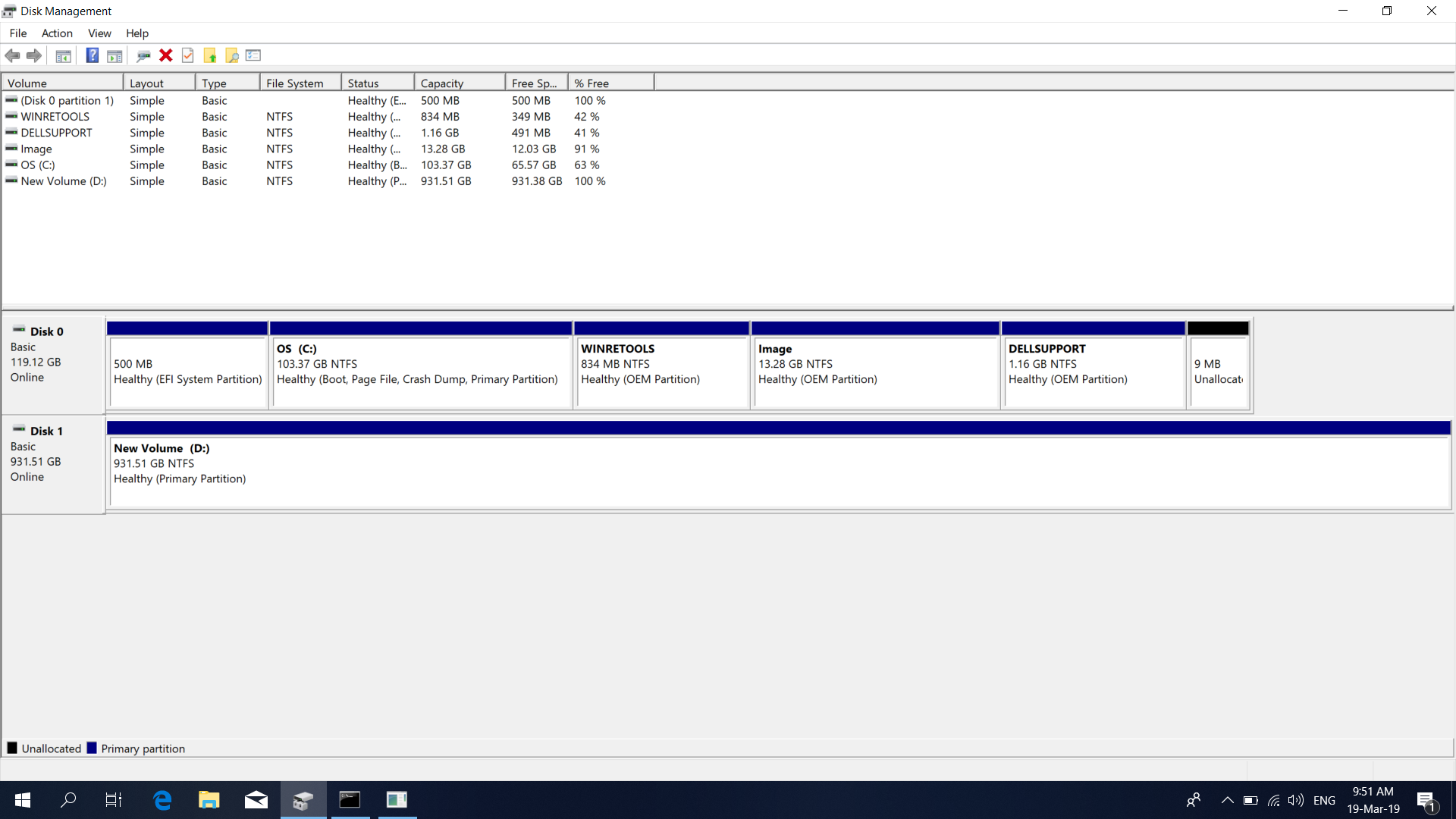

  4. How do I switch disk 1 to being disk 0, and disk 0 to being disk 1?
    How to combine disk 1 and disk 0? Or how take the volume from disk 1 to disk 0?
    How do I switch disk 1 to being disk 0, and disk 0 to being disk 1? 01323cbe-683f-4a91-a7e5-101a9134305a?upload=true.png
    AhmadEl Terkmanieh, Apr 5, 2020
