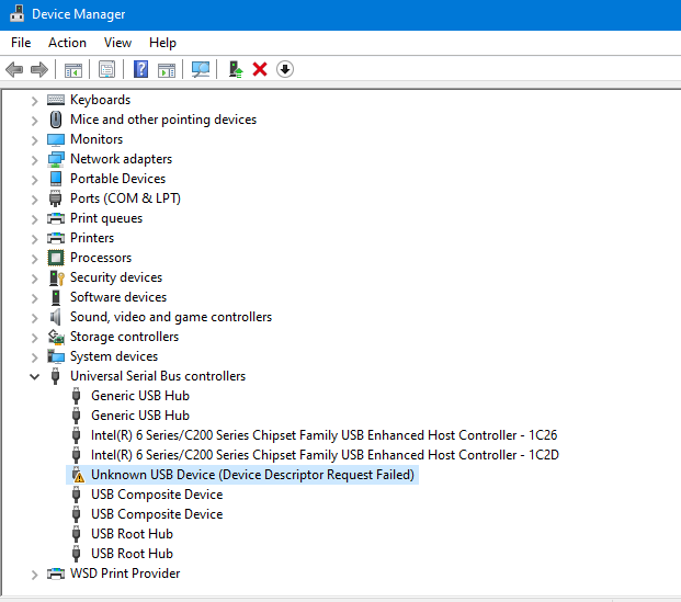

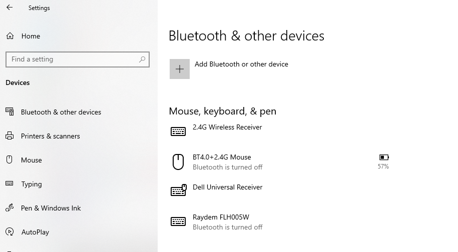

    I was just minding my own business as usual doing what I normally do on my computer, but then randomly, all my Bluetooth devices just disconnect. My headphones, mouse, and keyboard, which are Bluetooth just disconnect and won't connect back again.
    I went into the settings and tried to turn Bluetooth off and on, but that did nothing. So, I tried to restart, but when I came back, the settings page said "Bluetooth is turned off" and there's no switch to turn it on again. I went to device manager, and the entire "Bluetooth" section was missing. On top of that, in the USB controllers' section, there's a device that says "Unknown USB device Device descriptor Request Failed", and that's odd since I don't have any USB devices plug in apart from a USB drive That USB drive wasn't the problem, I took it off, but the problem remained.
    Is there any way to get Bluetooth back? It's kind of important since my mouse and keyboard all use it. And if possible, any help about that Unknown USB device? I've never seen that problem before.

  4. Tranbol Win User
    How do you fix bluetooth just disappearing for no reason?
    No bluetooth after system restore
    Thank you for your reply.
    I mean I have used a Windows system restore point. I tried restoring bluetooth with commands in CMD (sfc/scannow; DISM /Online.....) and by updating and uninstalling devices in the device manager. Update did not work. Uninstalling bluetooth devices made Bluetooth disappear out of the hidden devices list.
    All my steps I took worked but did not change anything in my bluetooth device list.
    I am using the bluetooth of my mainboard. MSI Z370M Gaming Pro AC
    My guess would be, that disabling the bluetooth network adapter before using a system restore point, disabled Bluetooth after using the system restore point.
    In the device manager I get this message in the USB Device list for a unknown USB Device:
    Windows has stopped this device because it has reported problems. (Code 43)
    A request for the USB device descriptor failed.
    Tranbol, Oct 27, 2020
