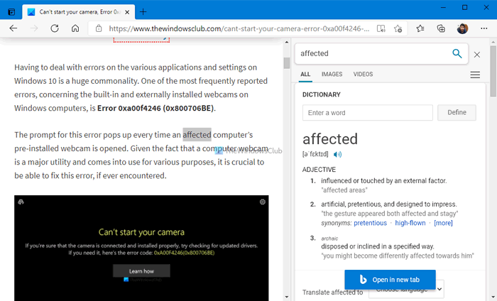

    The sidebar search panel of Search Bing in sidebar for option in the Edge browser helps you search for a keyword quickly while browsing a website. By default, Microsoft Edge has this functionality enabled, but you can hide or disable it using Registry if you want. As you don’t need to leave the current page, you can simultaneously browse two pages in one tab on the Edge browser using this feature.
    How to add or remove Sidebar Search Panel in Microsoft Edge add-remove-sidebar-search-panel-edge.png
    Let’s assume that you are reading an article on a website, but you are not getting a word, or you want to know more about a specific word found on a website. At such a moment, you have two options – one, you can copy the word and search for it in a new tab, and two, you can use the Search Bing in sidebar for “word” option. The former option lets you search for the word in your preferred search engine, i.e., Google, DuckDuckGo, etc. However, the latter option lets you search for the keyword only in the Bing search engine. As the sidebar search box is a fully-featured panel powered by Bing, you will get the same result as it displays while searching in a dedicated tab.

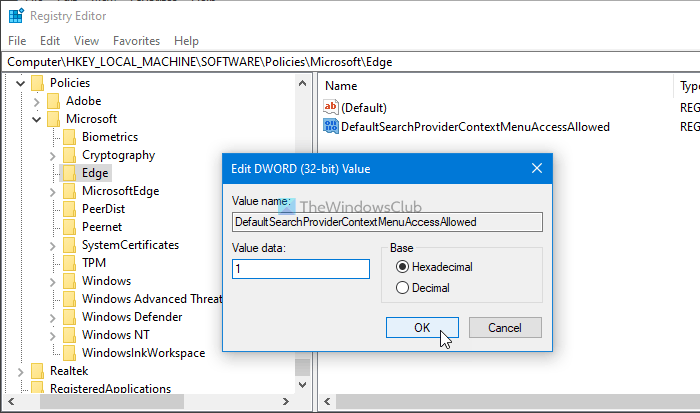

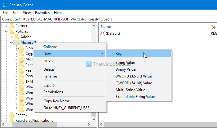

    At first, you have to open Registry Editor on your computer. For that, press Win+R, type regedit, press the Enter button and click on the Yes option.
    Then, navigate to the following path-
    HKEY_LOCAL_MACHINE\SOFTWARE\Policies\Microsoft
    Right-click on Microsoft > New > Key, and name it as Edge.
    How to add or remove Sidebar Search Panel in Microsoft Edge add-remove-sidebar-search-panel-edge-1.png

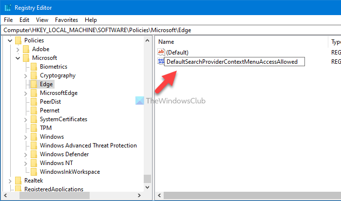

    Then, right-click on the Edge key, select New > DWOD (32-bit) Value.
    Name it as DefaultSearchProviderContextMenuAccessAllowed.
    How to add or remove Sidebar Search Panel in Microsoft Edge add-remove-sidebar-search-panel-edge-2.png
    Double-click on this REG_DWORD value, and set the value data as 1 to enable and 0 to disable.
    How to add or remove Sidebar Search Panel in Microsoft Edge add-remove-sidebar-search-panel-edge-3.png
    At last, click on the OK button to save the change.
    How to add or remove Sidebar Search Panel in Microsoft Edge add-remove-sidebar-search-panel-edge-4.png

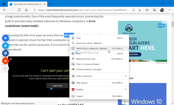

    Once you have enabled this feature, you can visit any webpage, highlight a word, and right-click on it to find the Search Bing in sidebar for “word” option.
    That’s all!

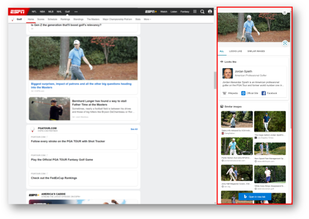

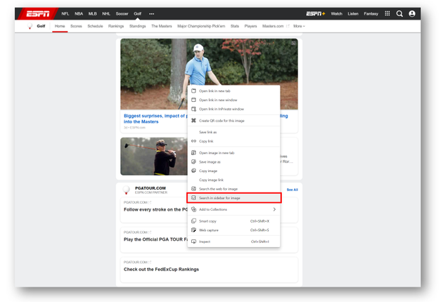

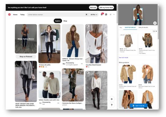

    Microsoft introduces Search in Sidebar for Images in Microsoft Edge
    Source: https://techcommunity.microsoft.com/...he/m-p/2342015
