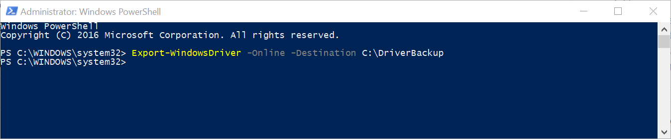

    First, you'll need to open PowerShell as an Administrator. To open an elevated PowerShell prompt, in the taskbar search bar, type powershell. Now see the result Windows PowerShell which appears on the top. Right-click on it and select Run as Administrator.
    We will be using the Export-WindowsDriver cmdlet to back up your drivers. The Export-WindowsDriver cmdlet exports all third-party drivers from a Windows image to a destination folder.
    In the PowerShell window, type the following command and hit Enter:

    Here C:\DriverBackup is the destination folder, where the device drivers will be exported and saved to.

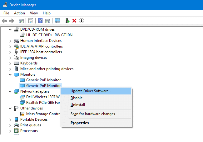

    1. Open Device Manager, by pressing Windows + R keys and type Devmgmt.msc into opened Run box, press Enter key.
    2. Right-click on a hardware and click Update Driver Software.

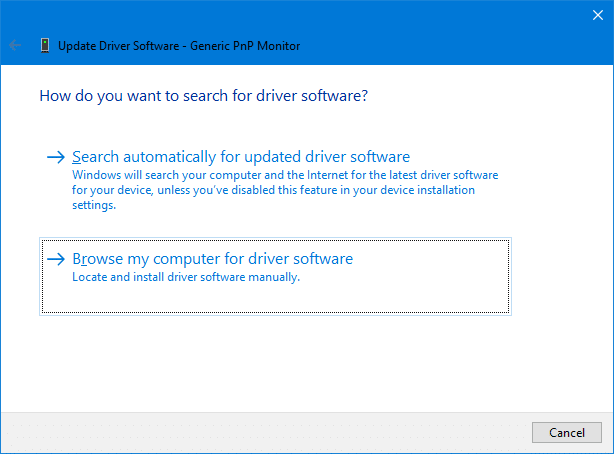

    3. Select the second option, Browse my computer for driver software.

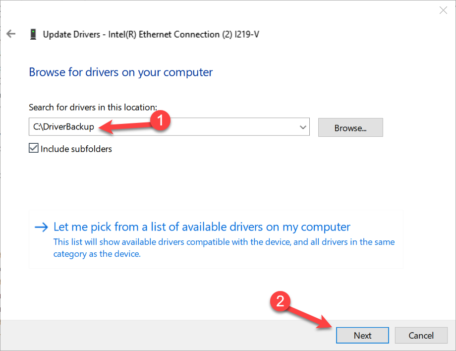

    4. Input or browse to the drivers backup folder path.
    How to Backup and Import Device Drivers in Windows 10 Using PowerShell nqf92FG.png
    5. Click Next and Windows would automatically find and pick the required drivers in one of the sub-folders, if "Include subfolders" is enabled.
