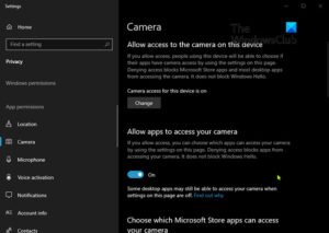

Discus and support How to change default Webcam in Windows 10 in Windows 10 News to solve the problem; [ATTACH]If your laptop’s internal webcam no longer works or has been replaced by a […] This article How to change default Webcam in Windows 10 first... Discussion in 'Windows 10 News' started by WinClub, Jan 14, 2021.
