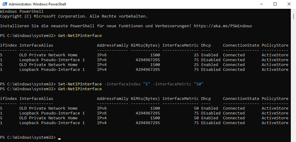

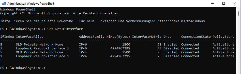

    One of the first things that you may want to do is check current priorities of all networking adapters.
    1. Select Start.
    2. Type Powershell.
    3. Select "run as administrator".
    4. Run the command Get-NetIPinterface in the PowerShell window.
    The command returns all network adapters and their interface index numbers plus other information, e.g. the connection state.
    The index number, displayed in the first column, is unique for each network adapter. The InterfaceMetric value defines the priority. Lower InterfaceMetric numbers are prioritized over larger numbers.

    All that is required now is to set the values according to the requirements.
    The base command for that is Set-NetIPInterface -InterfaceIndex "XX" -InterfaceMetric "YY".
    • InterfaceIndex refers to the current ifIndex of the network adapter.
    • InterfaceMetric sets the new priority of the network adapter.
    Here is an example:
    • Set-NetIPInterface -InterfaceIndex "5" -InterfaceMetric "50"
    This changes the priority of the network adapter with the interface index 5 to 50. Note that there is no confirmation message.
    How to change network adapter priorities on Windows 11 change-network-adapter-priorities-windows-11-powershell.png
    Tip: the command is very powerful, as it supports parameters to change certain network adapter specific attributes, e.g. add -Dhcp Disabled to disable DHCP for the specified adapter.
    Once you are done, run the Get command again to make sure that the changes were set correctly.

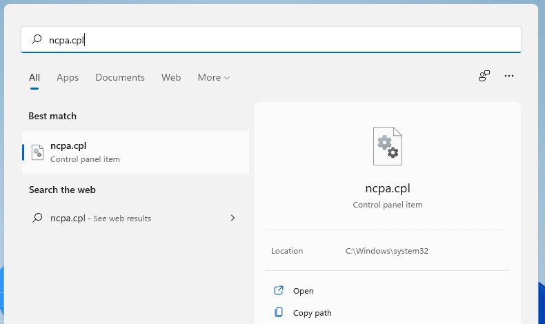

    Select Start. Type ncpa.cpl and run the command; this opens the Network Connections control panel applet. Tip: check out our full list of commands to open Control Panel applets on Windows.

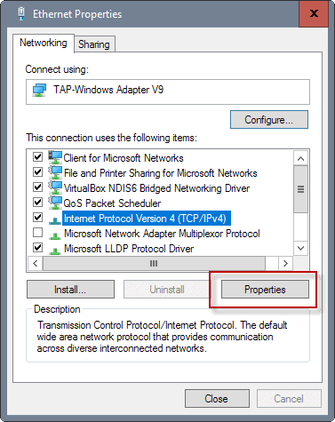

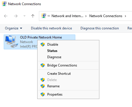

    Right-click on the network adapter that you want to change the priority for, and select properties from the context menu that opens.

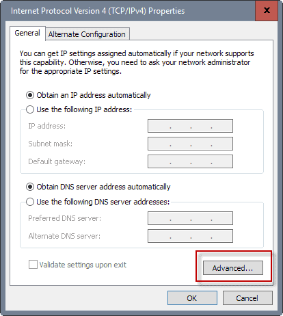

    Locate Internet Protocol Version 4 (TCP/IPv4) or Internet Protocol Version 6 (TCP/IPv6) and select the properties button. If you want to change the priority for both, repeat the process multiple times.

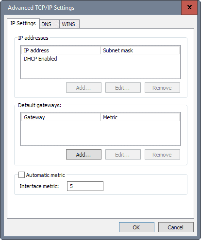

    Select the Advanced button on the next screen that opens.
