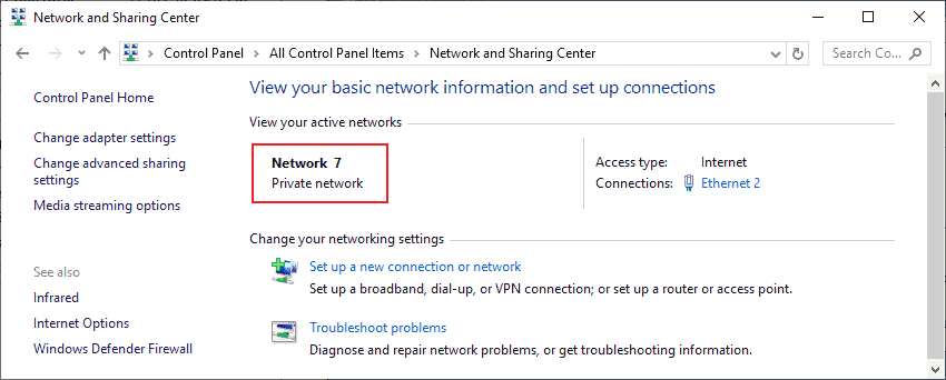

    You can check the current name in the Network and Sharing Center on Windows or in the Settings application on Windows 10.
    1. Tap on Windows-I to open the Settings application.
    2. Go to Network & Internet > Ethernet or Wi-Fi depending on the connection type.
    The name of the network is displayed at the very top of the page.
    To display the name in the Control Panel instead, do this:
    1. Tap on the Windows-key to activate the Start menu.
    2. Type Control Panel and select the result.
    3. Go to Network and Sharing Center
    The name is listed under "view your active networks".

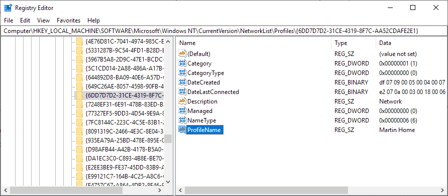

    Using the Windows Registry
    How to change network names on Windows 10 change-network-name-registry-windows.png
    I recommend that you back up the Windows Registry before you make any changes to it. Check out our Windows Registry backup guide to find out how to do that.
    1. Open the Start Menu.
    2. Type regedit.exe and select the result to open the Registry Editor.
    3. Confirm the UAC prompt that is displayed.
    4. Go to HKEY_LOCAL_MACHINE\SOFTWARE\Microsoft\Windows NT\CurrentVersion\NetworkList\Profiles
    5. The next step requires some trial and error. Windows lists all network connections with a unique ID and you need to click on each to check the ProfileName variable of it until you find the network name that you want to change.
    6. Double-click on ProfileName once you have found the right entry and type the new name of the network that you want used on the device. The change is only active on the device.

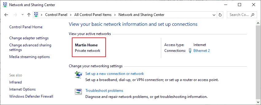

    The change takes affect immediately. You can verify that by opening the Settings app or the Network and Sharing Center to verify that the name change was successful.

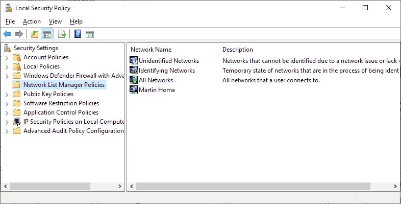

    Using Local Security Policy
    As mentioned earlier, Local Security Policy is only available in professional versions of Windows. A limitation of this method is that you can only change the name of the connected network.
    2. Type secpol.msc and select the result from the list of results. This opens the Local Security Policy on the device. Tip: Check out our list of Windows msc files that you can run here.
    3. Select Network List Manager Policies on the left.
    4. Double-click on the name of the network the device is connected to at the time. A new window opens.
    5. Select "Name" under Name and add a new name for the network that you want used by Windows.
    6. Click ok.

    Press Windows Key + R, type secpol.msc and press Enter to run it. In Local Security Policy window, go to the Network List Manager Policies in the left pane. Now in the right pane double click on the network name that you want to change. In the Properties windows under the Name section make sure that Name is selected. Now in the input field enter the name that you wish to use for your connection. Click Apply then OK to save the changes. And you might have to log in again or to restart your computer before the changes are applied.
