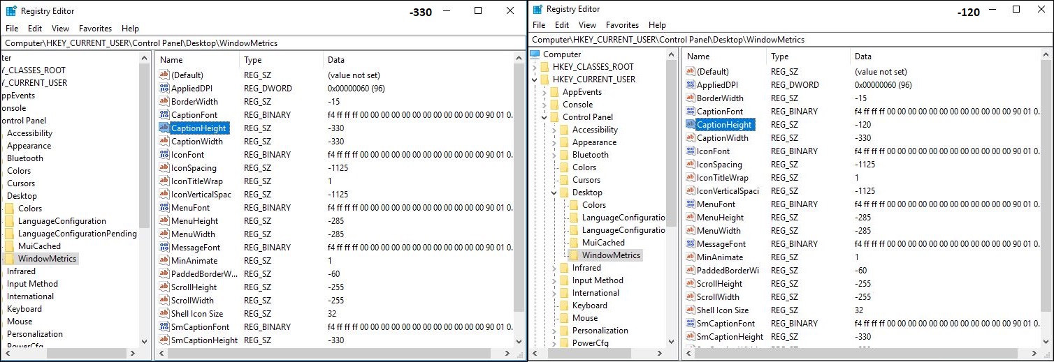

    You can resize the window caption buttons using the Registry Editor (regedit). Please make sure that you're signed in as the administrator before performing the steps below. Also, this section, method, or task contains steps that
    tell you how to modify the registry. However, serious problems might occur if you modify the registry incorrectly. Therefore, make sure that you follow these steps carefully. For added protection, back up the registry before you modify it. Then, you can restore
    the registry if a problem occurs. For more information about how to backup and restore the registry in Windows 10, refer to this
    support article.
    1. Click the Start button, type regedit and then press
      Enter.
    2. If prompted, choose Yes or enter the administrator password.
    3. Navigate to the key below.
      • HKEY_CURRENT_USER\Control Panel\Desktop\WindowMetrics
    4. Select WindowsMetrics.
    5. On the right-side pane, double-click the CaptionHeight string to modify it.
    6. The default value for the string is -330. You can change it to
      -120 to reduce the size of the caption buttons.
    7. Click OK, close the Registry Editor and then restart your PC for the changes to take effect.
    See the image below for a comparison between
    -330 and -120.
    How to change Windows 10 button style? a109ad2b-4505-4c2f-803a-33cc07d88a34?upload=true.jpg
    Changing the overall visual look of the Windows Explorer is not advised as it may cause system corruption that may render your machine unusable. If you still want to continue, you can search for a third-party software that can perform this procedure.
