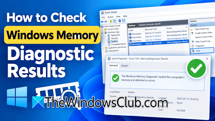

  2. Memory diagnostic test results not found
    This is very unusual that you are unable to find the results for Memory Diagnostic test.
    Usually, when the memory diagnostic is complete the results will be stored under Event Viewer. Kindly follow the steps mentioned below to access Event Viewer logs for Memory Diagnostic.
    1. Press Windows key + R. This will open
      Run. Alternatively, you can go to Start and search for Run.
    2. In Run dialog box, type eventvwr and hit enter.
    3. Now expand Windows Logs and click on
      System.
    You can use the filter or the find option in Event Viewer to check for specific logs. You can try the steps mentioned below to filter memory diagnostic results in Event Viewer.
    1. Right click on System and click on
      Find.
    2. Now type Memory Diagnostic results and click on
      Find Next
    This should pull up the results for Memory Diagnostic that you have ran.
    Let us know if there are any concerns, we will certainly assist you further.

    Typically, the Windows Memory Diagnostic tool will indeed post an event in the Event Viewer under 'Windows Logs' > 'System' with a source of 'MemoryDiagnostics-Results' after completing a scan, regardless of whether it found errors or not. If you do not see any 'Results' entries, it might indicate that the test did not complete properly or there was an issue in logging the results.
    Here are a few steps you can take to troubleshoot this issue:
    1. Re-run the Memory Diagnostic: Sometimes, re-running the diagnostic can help if the previous attempt was somehow interrupted or did not complete. Restart your computer and during boot-up, press F8 to trigger the diagnostic tool again.
    2. Check Alternative Log Views:
      • Although you've already checked the System logs, sometimes entries can be misfiled. Check other sections in Event Viewer such as 'Application' and 'Setup'.
      • You can also use the general filter to search for terms like 'memory' instead of using the pre-set filters to see if any related logs appear elsewhere.
    3. Use Command Line to View Results:
      • You can also try to view the memory diagnostic results using the Command Prompt. Open Command Prompt as an administrator and type the following command:
      • eventvwr.msc
      • This opens Event Viewer directly. Then use:
      • wevtutil qe System "/q:*[System[(Provider/@Name='Microsoft-Windows-MemoryDiagnostics-Results')]]" /f:text
      • This command queries the System logs for entries from the Memory Diagnostics tool and displays them in a text format.
