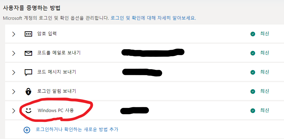

    When I try to remove Windows Hello from my login method by accessing the Microsoft account site, it does not appear on the listfigure1.

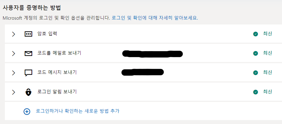

    Eventually I managed to make Windows Hello appear in the list, by means of removing and resetting the PIN in Windows settings, and manually adding Hello on the MS account sitefigure2.

    However, even if I removed Windows Hello from here, I could still access MS sites through Windows Hello.
    Changing the password for my MS account and logging out from a trusted device couldn't block Windows Hello.

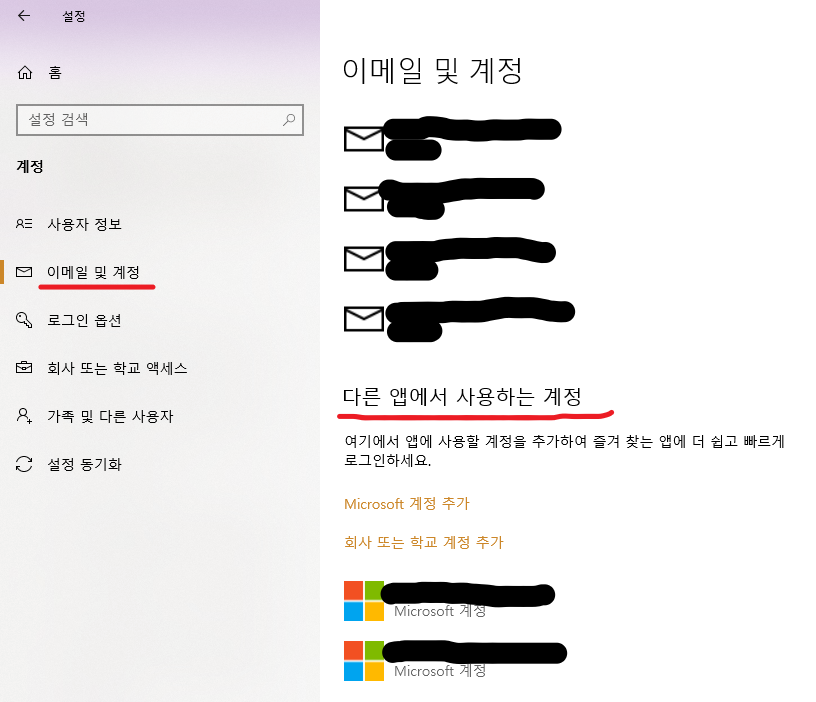

    I have confirmed that this problem occurs with the Microsoft account included in "Accounts used by other apps" in Windows Settingsfigure3.
