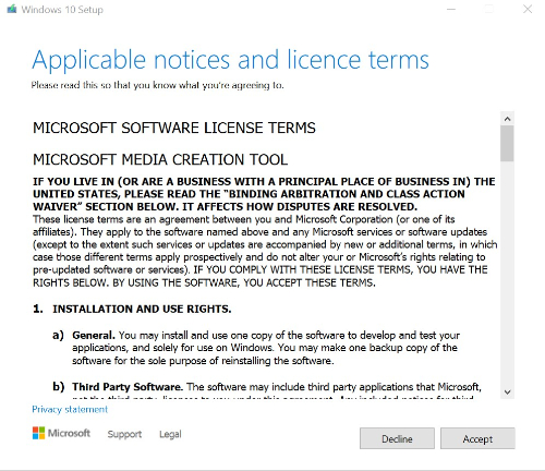

    6. It will ask you to accept the Terms and Conditions, if you accept, press accept:
      If you decline, you will be unable to use the tool
      How to do a Windows 10 Repair Upgrade 4a02b8a2-593b-432a-b198-b184d707558a?upload=true.jpg

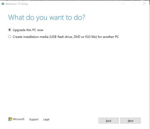

    8. When you are asked "What do you want to do?" - Press upgrade this PC now:
      How to do a Windows 10 Repair Upgrade 00a26846-0f66-4577-9e29-f43605373ca4?upload=true.jpg
    9. Press Next

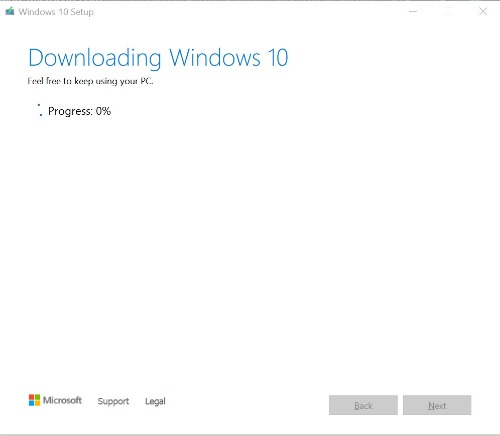

    10. The setup will now download windows 10 - Please wait, this can be lengthy:
      How to do a Windows 10 Repair Upgrade 77a26b7f-ca88-4695-b635-932ccf8b0de2?upload=true.jpg

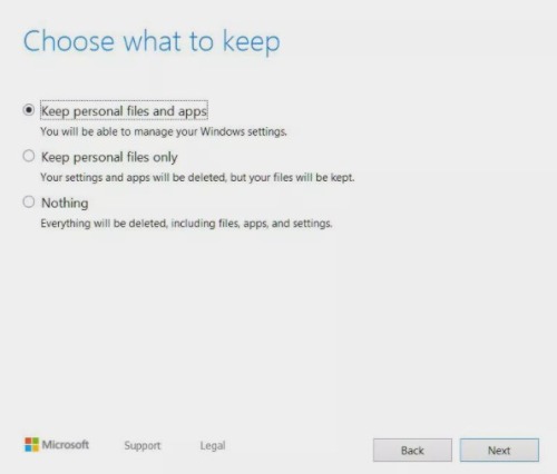

    11. Once that is complete you will be prompted with this, select keep my files and apps:
      How to do a Windows 10 Repair Upgrade e48e8f56-e333-480b-a6dc-6005b0dd5261?upload=true.jpg

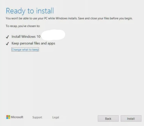

    13. Now, press install and the setup will do the rest!
