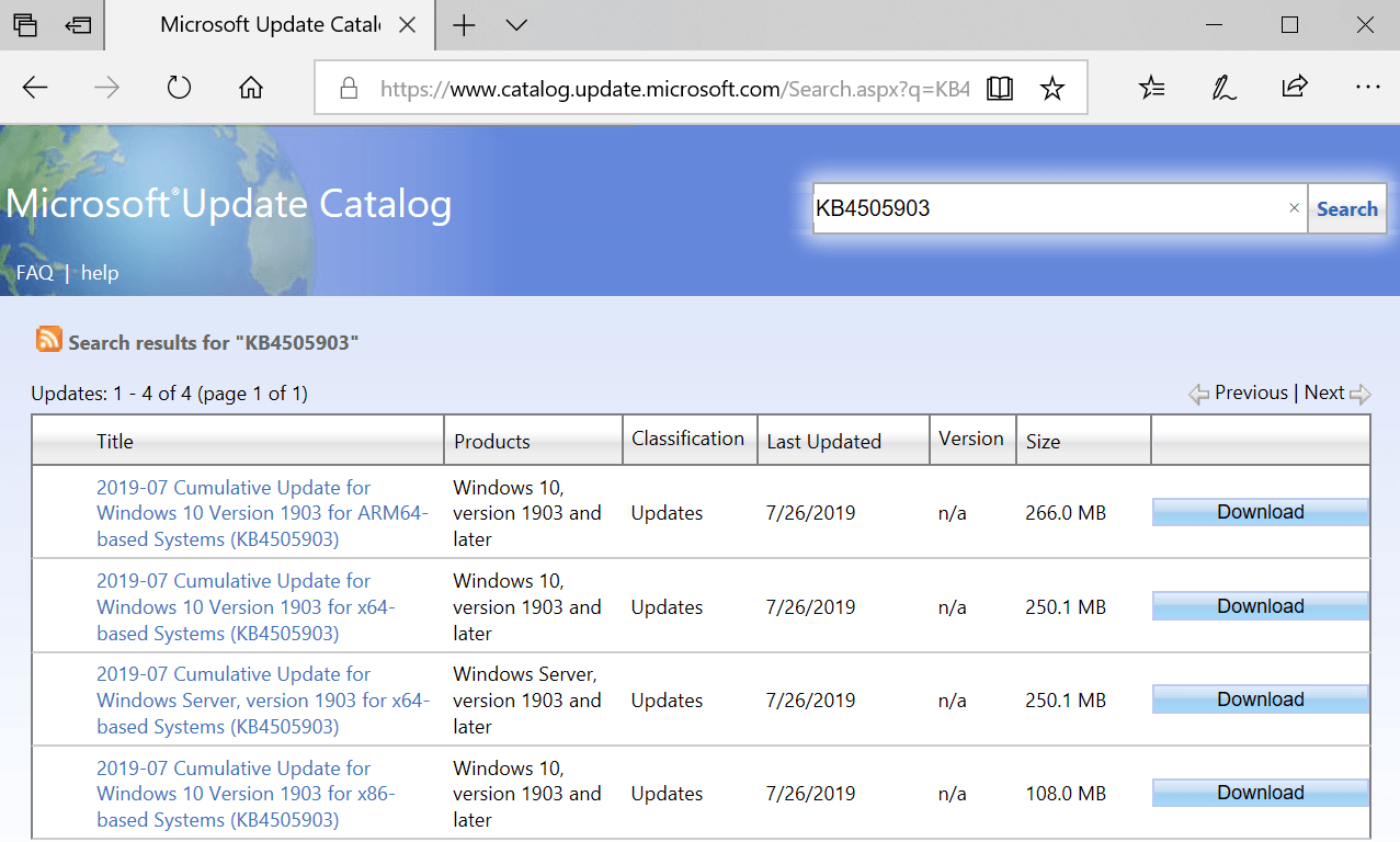

    Microsoft publishes most updates that it releases on the Microsoft Update Catalog website. Think of the site as a searchable directory of updates released by Microsoft; you find all cumulative updates for Windows there as well as many other patches for Windows and other Microsoft products.
    Search should start with a KB (Knowledgebase ID). You get those from support articles that Microsoft releases, blog posts on sites like Ghacks, or by using third-party tools to check for updates.
    Just paste the KB ID in the search field and hit the Enter-key to run a search; you get multiple results returned often as updates are usually offered for multiple architectures.
    One example: the KB4505903 search returns four items for ARM64, x64, x64 for Windows Server, and x86 architectures.
    Tip: if you need to look up information about the PC to determine which update applies to it, run system information from the Start menu.
    Hit the download button next to the update that you want to download to your system. One of the advantages of using the Microsoft Update Catalog is that you can download updates for other devices as well as you are not limited to download "matching" updates only. Windows Update blocks any updates that are not designed for the computer's hardware.

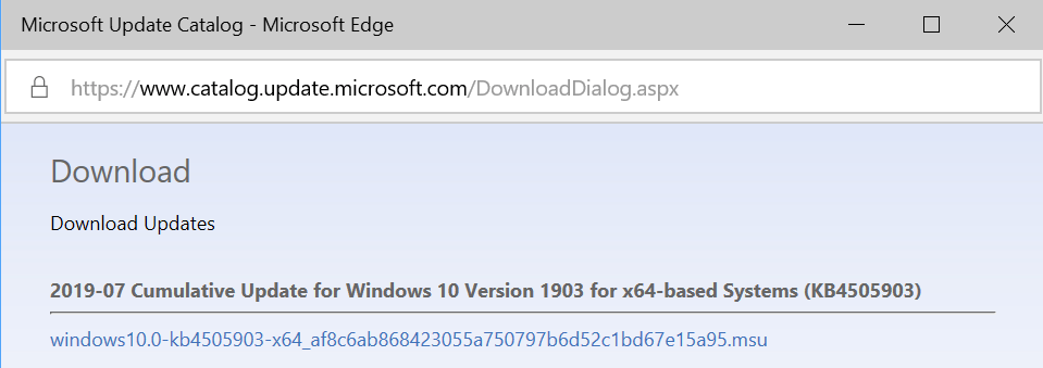

    The Microsoft Update Catalog website opens a popup that lists all the files for that particular update. You may get multiple files there or just a single file.
    How to download and install Windows updates manually microsoft-update-catalog-download.png
    Use the browser to download all of them, e.g. by right-clicking on files and selecting the save as option. Updates are provided as MSU files usually.
    All that is left to do then is to double-click on the downloaded MSU file to install the update. Most updates require a reboot.
