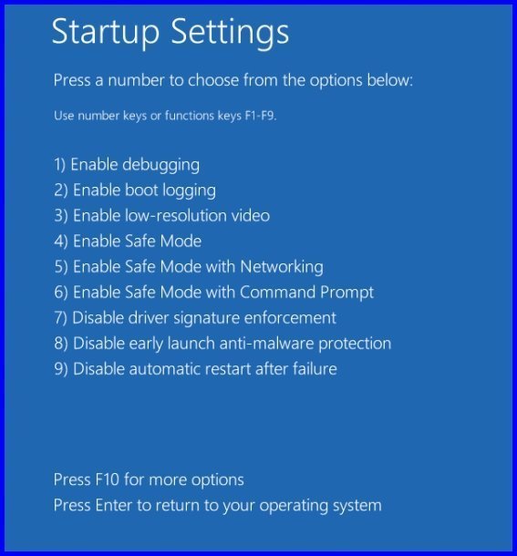

    I've read a million posts by people who find it difficult to boot into Safe Mode.
    It's really quite simple.
    Run the following command in an Administrator Command Prompt ---
    bcdedit /set {globalsettings} advancedoptions true
    In the future every time you reboot a blue page will appear with boot options as shown in the picture below ---
    How to easily boot into Safe Mode, etc. 26087f30-6d21-4e5a-8d3c-78924f70806d?upload=true.jpg
    If you want to get rid of it, run this command in an Administrator Command Prompt ---
    bcdedit /set {globalsettings} advancedoptions false
    That's all.
