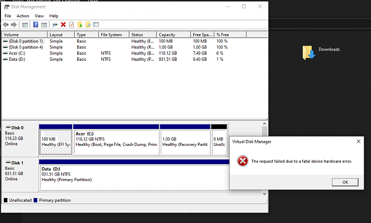

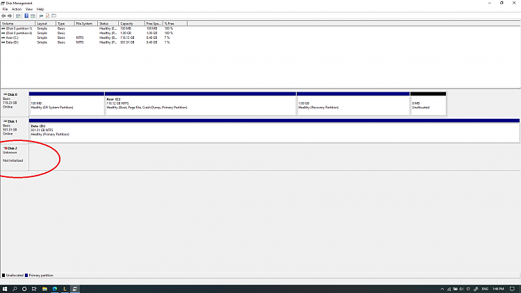

    So I did some research and still I cannot fix this problem.
    Early this morning I was transferring my files from my laptop to my external because my laptop is getting full already and accidentally plugged out the external while transferring files. Now my external hard drive will not show up on my computer whenever I try to plug in.
    So here how it looks like on the disk management, whenever I try to initialize it says:
    the request failed due to a fatal device hardware error

    I'm also trying to recover files with EaseUS, the problem is the external cannot be detected on the pc itself, it only says disk 2.
    Thanks in advance to anyone who could help me out.
