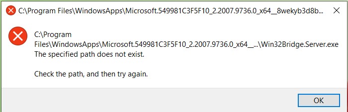

    How to fix this Error - WindowsApps c57d6129-d8de-422e-aa6b-a18b03d64a3d?upload=true.jpg
    This morning got this error, how to fix this!
    Plz reply me..

  2. WINDOWSAPPS FILE
    For us to provide you an accurate resolution regarding your WindowsApps folder issue, we would like to know the following:
    • Were there any updates made on your computer prior to this concern?
    • Send us a screenshot of your WindowsApps and WindowsAppsOld folders so that we can double check the issue.
    • When did the issue first begin?
    • What troubleshooting steps have you taken so far to resolve this?
    Michael Gall, Aug 3, 2020
  3. S.cloris Win User
    WindowsApps folder says permissions are corrupted and need to be deleted, is this normal or critical?
    According to your description, I suggest you try the following steps:
    1. Navigate to the location C:\Program Files.
    2. Right-click on the WindowsApps folder, and select Properties.
    3. Turn to Security tab and click on Advanced.
    4. Click on Change and then type Users in Enter the object name to select area.
    5. Click on OK, then click Apply > OK. You can also add the TrustedInstaller to the users list and check if it takes effect.
    However, you might be still not able to access the files. The workaround is to go inside the C:\Program Files\WindowsApps\, and repeat the same way with the Microsoft.WindowsStore* folders.
    S.cloris, Aug 3, 2020
