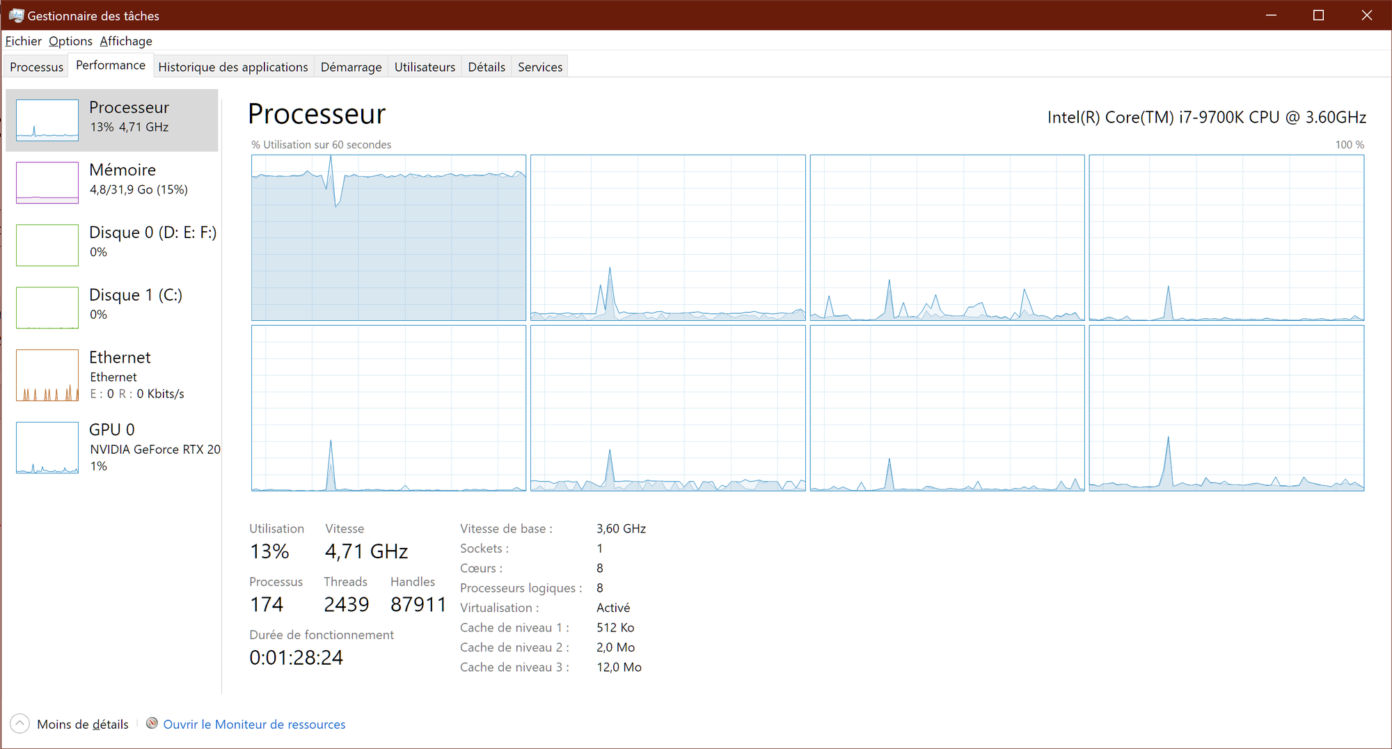

    I have a recent machine (i7 9700K with an Aorus Z390 master motherboard and an nvidia GeForce card with Windows 10 May 2019 edition).
    When the computer is started there is no issue, but after a few minutes the core 0 of my CPU is near 100% all the time despite no particular app running :
    How to know which kernel component is taking near 100% CPU-0 time ? d3140556-2fee-49a0-b715-716ceaeb4ba0?upload=true.png
    The darker blue shows cycles are spent in kernel code, light blue shows the cycle spent in userspace. So basically Something is happening in Windows kernel, maybe a bug with a driver.

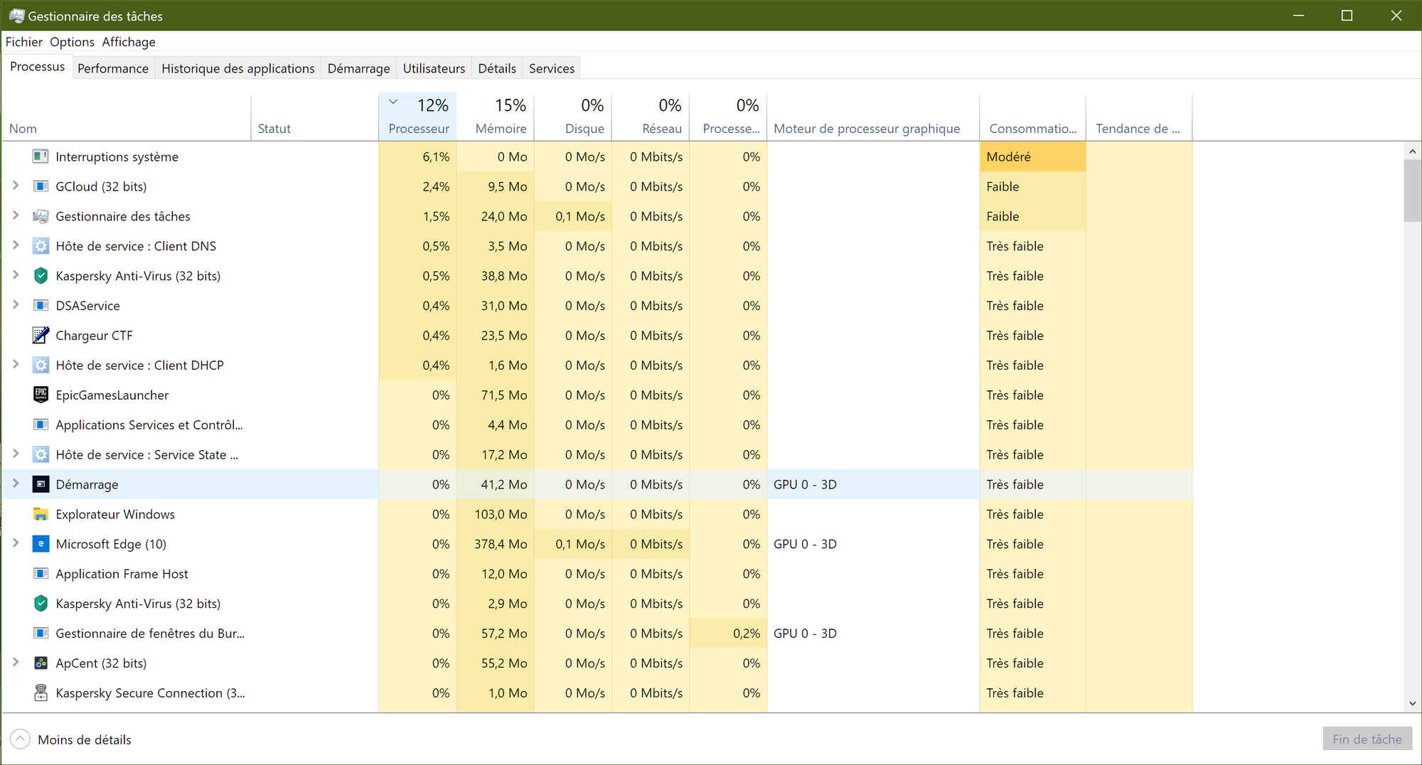

    The task manager is reporting a very low cpu usage for my app :
    How to know which kernel component is taking near 100% CPU-0 time ? d90b4173-c486-4b33-bc8a-92a3c8a1b06d?upload=true.png
    This means that my cpu is always throtthling.
    I reinitialised my computer and reinstalled only a couple drivers (Realtek audio, nvidia, some gigabyte app, and no Intel drivers I use the one from the OS) and it still happens.
    I don't know how to debug the issue. I've tried with Windows Performance Toolkit but unfortunatly it doesn't show what happens in the kernel.
    I Don't think it's an hardware issue since on the same computer I run Fedora 30 and almost never hit more than 30% cpu usage for a core even when using Firefox.
