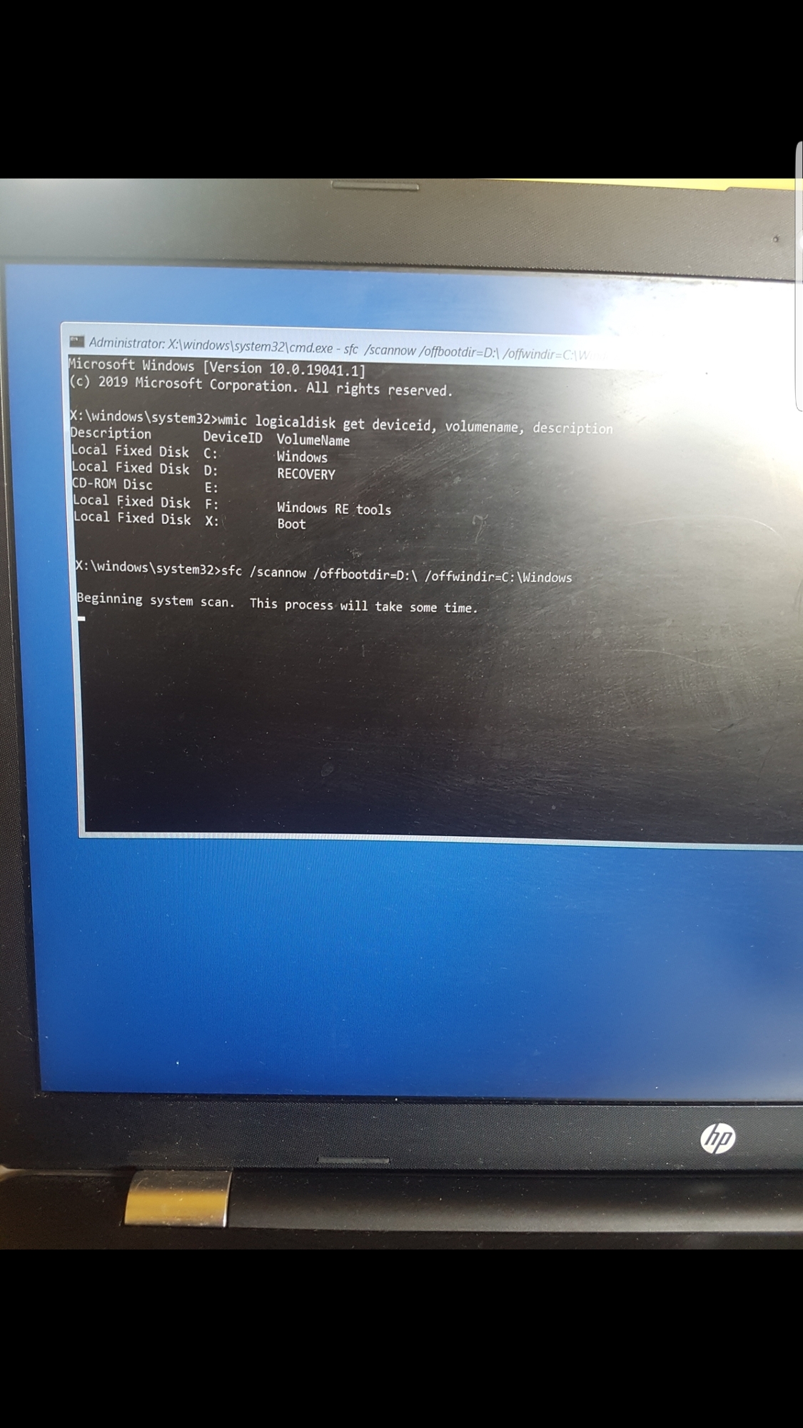

    Hi i recently did an sfc scannow and got some components could not be fixed so tried sfc offline scan and got no errors. Could i have done the offline scan wrong? I have hp laptop windows 10, only 2 hard drives windows c and recovery D. What is the correct sfc offline scan format.
    NOTE:i am having a bundle of system failures where explorer.exe crashes and files/apps take ages to load and settings/control pannel are either empty of not responding How to preform sfc offline scan a9fc7893-2aa5-44fd-a71d-c404f23d6c4a?upload=true.jpg

  4. dalchina Win User
    SFC scannow offline
    To find your Windows drive letter from an offline command prompt or having booted your PC from a boot disk such as Kari's very useful one available from the top of the Software and Apps section here:
    a. the simple, crude pragmatic approach- from a command prompt use the DIR command on the various drive letters available and so discover which drive letter contains your Windows folder
    b. the more sophisticated approach:
    use BCDEDIT - see step 5 in the guide below:
    SFC Offline:
    How to Run SFC OFFLINE (System File Checker tool) - wintips.org - Windows Tips How-tos
