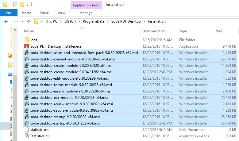

    I found a way to uninstall Soda PDF from my computer without too much trouble. I am running Windows 10 with Soda PDF v9.
    I found the Soda PDF installation files located in: "C:\ProgramData\Soda PDF Desktop\Installation" & there were 12 .MSI files that I used to uninstall the software:
    how to remove a process (soda PDF) from win 10 30e6c34e-b99b-4dd8-a77b-dfc0e21dc189.jpg

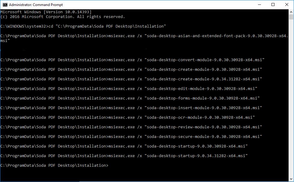

    I then launched a Command Prompt (click Windows Start button, type cmd.exe, right-click cmd.exe, & click Run as Administrator).
    I changed to the Soda PDF Installation directory (cd "C:\ProgramData\Soda PDF Desktop\Installation" & press enter)
    I then entered the following command for each .MSI file above (your files may have different names and need to be entered accordingly: msiexec.exe /x "soda-desktop-(REMAINDER OF FILENAME).msi" & press enter. Click Yes to uninstall the product & follow the
    prompts. Some of the files stated "This action is only valid for products that are currently installed". This just means that particular module was not installed. Continue to the next .MSI file.

    Once I uninstalled all the 12 .MSI files I closed the Command Prompt & deleted the Soda PDF installation folder "C:\ProgramData\Soda PDF Desktop"
    I then rebooted the computer & no more Soda PDF.
    I hope this helps others as it worked great for me and took less than 5 minutes! Be careful & use at your own risk...
