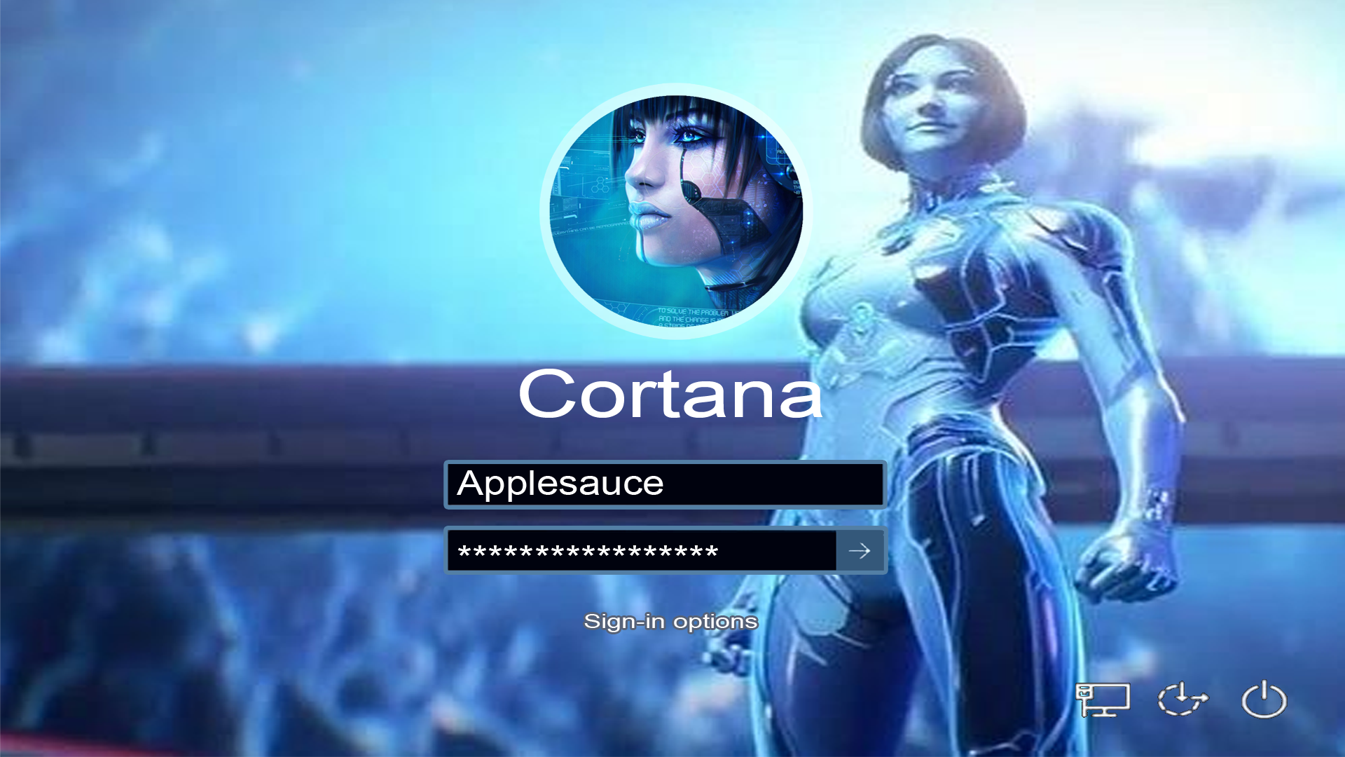

    So I attempted to find an answer to this with no real solution that wouldn't compromise my Windows 10 OS. The only option was to eliminate the lock screen, which was not a viable solution. The thread was locked that I wanted to reply to, so I created a new discussion here. After speaking with Siri and getting nowhere, figures! I figured out a workaround. You'll need a background image to use 1920x1080. If needed, I have supplied one by using Apple's easy bake oven. Tim Cook was a swell chap to lend it to me. Look for it below the instructions.

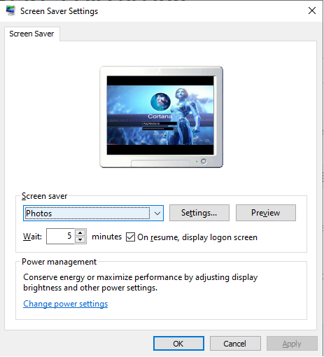

    1. Type "screen saver in the search bar"
    2. Click "change screen saver" from the start menu
    3. Select photos

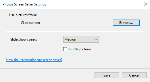

    4. Click "Settings" How to remove windows 10 lock screen clock and date 9239f187-f284-4f2e-80ee-38d40ca987df?upload=true.png

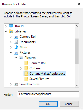

    5. Then Click "Browse" How to remove windows 10 lock screen clock and date 9f52dea5-101c-44ca-a6ad-ef7edf0b450b?upload=true.png
    6. Create another folder and name it "CortanaMakesApplesauce" or whatever you like. I just like Applesauce How to remove windows 10 lock screen clock and date :p How to remove windows 10 lock screen clock and date 2c829563-b516-42c6-8a93-ef8827fbf7a1?upload=true.png
    7. Next, select that folder This is so you aren't rotating through the other pictures.

    1. Click "OK"
    2. Then "Save"
    3. Check "on resume", display logon screen
    4. Select your wait time from the dropdown.
      • I put 5 minutes :
      • That's how long it took me to make Applesauce.
      • I should ask for a faster proc.
    5. Then click "apply"

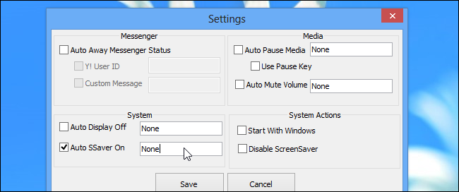

    To start the the screensaver immediately on lock, install this FREE program called MonitorES formerly Monitor Energy Saver
    MonitorES formerly Monitor Energy Saver [Softpedia link]
    1. Download and install
    2. Open the program
    3. Go to preferences accessible from the system tray icon "green white gears", bottom right corner on the taskbar
    4. Right click
    5. Next select "settings"
    6. Then check/enable the Auto SSaver On optiondon't worry about writing anything in the box. Leave it on "None"
    7. Click "Save"
    How to remove windows 10 lock screen clock and date 28b8d51b-0620-495d-b0af-a3deaf55240a?upload=true.png

    This worked for me since my clock is internal anyway. I hope this works for everyone else.
    CORTANA'S LOCKSCREEN FREEBIE: My bad on the resolution, the best pictures of me are hard to find. haha
