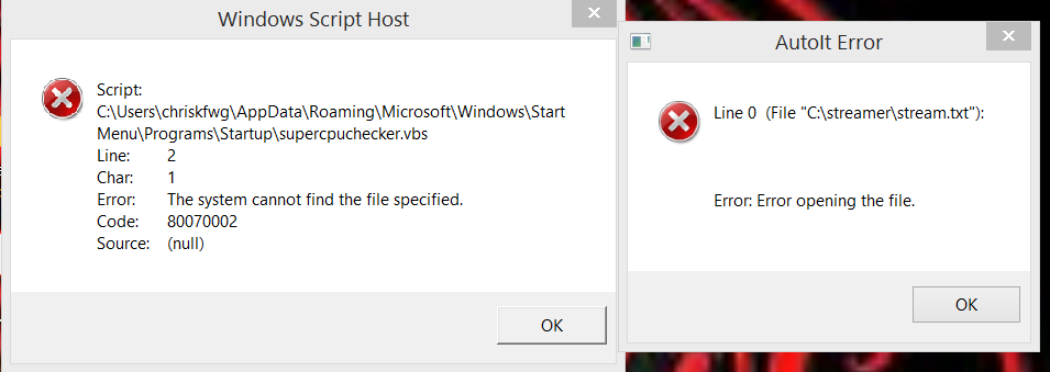

    Could you please help? Need to figure out how to remove the following scripts when starting the computer.
    how to remove windows script host 372d07d9-ede7-44a2-bcc0-86ac621876f8?upload=true.png

    The message "Windows Script Host access is disabled on this machine. Contact your administrator for details" is usually occurring if a program that does not require the feature of Windows Script Host is running on a Windows PC. For us to provide an accurate

  4. Allan Mej Win User
    Windows Script Host
    Hi Boniface,
    Windows Script Host provides your PC the scripting abilities like
    batch files, but Windows Script Host offers more features. You can enable
    Windows Script Host to stop 'Windows Script Host is disabled on this machine, contact your administrator for details'
    message by following these steps:
    • Press Windows + R to open Run.
    • Type regedit and press Enter to open the
      Registry Editor.
    • Navigate to this key: HKEY_LOCAL_MACHINE\Software\Microsoft\Windows Script Host\Settings.
    • On the right panel, double-click Enabled and change the
      Value data to 1.
    • Save the changes and exit the Registry Editor.
      Note: Do not modify other keys on the Registry without having enough knowledge about that registry key as it may cause some failures on your PC
    Let us know how things go.
    Regards.
