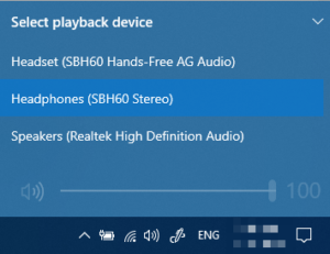

Windows 10: How to rename Audio Output devices in Windows 10
Discus and support How to rename Audio Output devices in Windows 10 in Windows 10 News to solve the problem; [ATTACH]When it comes to devices, people always tend to surround their lives around them. In day to day life, the priority of our lives is […] This... Discussion in 'Windows 10 News' started by WinClub, Mar 27, 2020.
  1. WinClub New Member
