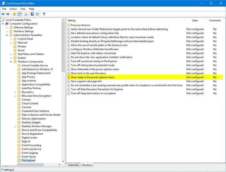

    Method 3: Add Sleep in Power Menu using Local Group Policy Editor.
    The Local Group Policy Editor is only available in the Windows 10 Pro,
    Enterprise, and Education editions.
    1. Press Windows + R
      keys to open the run command box.
    2. Type gpedit.mscin Run, and click/tap on
      OKto Open the Local Group Policy Editor.
    3. In the left pane of Local Group Policy Editor, navigate to the location below
      Computer Configuration/Administrative Templates/Windows Components/File Explorer
    4. In the right pane of File Explorerin Local Group Policy Editor, double click/tap on the
      Show sleep in the power options menupolicy to edit it.
    5. Select (dot) Enabled, click/tap on
      OK.

    Try Enable Sleep Mode Using Group Policy
    1.Open the Local Group Policy Editor. Navigate to Computer Configuration -> Administrative Templates -> Windows Components -> File Explorer.
    2.On the right side panel, double-click on Show sleep in the power options menu settings in the list as shown.
    3.In the next window that opens up, select either Enabled or Not Configured and then click OK.
    This would add the Sleep option in the Power Options menu in Windows.
