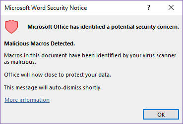

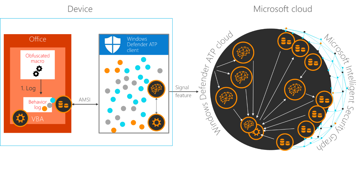

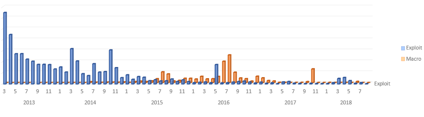

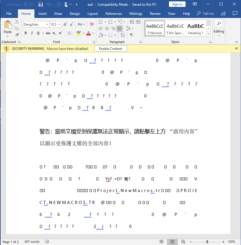

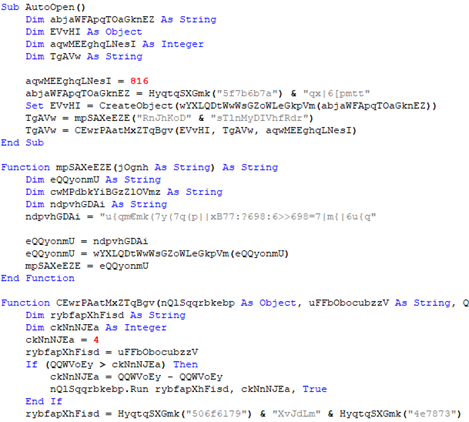

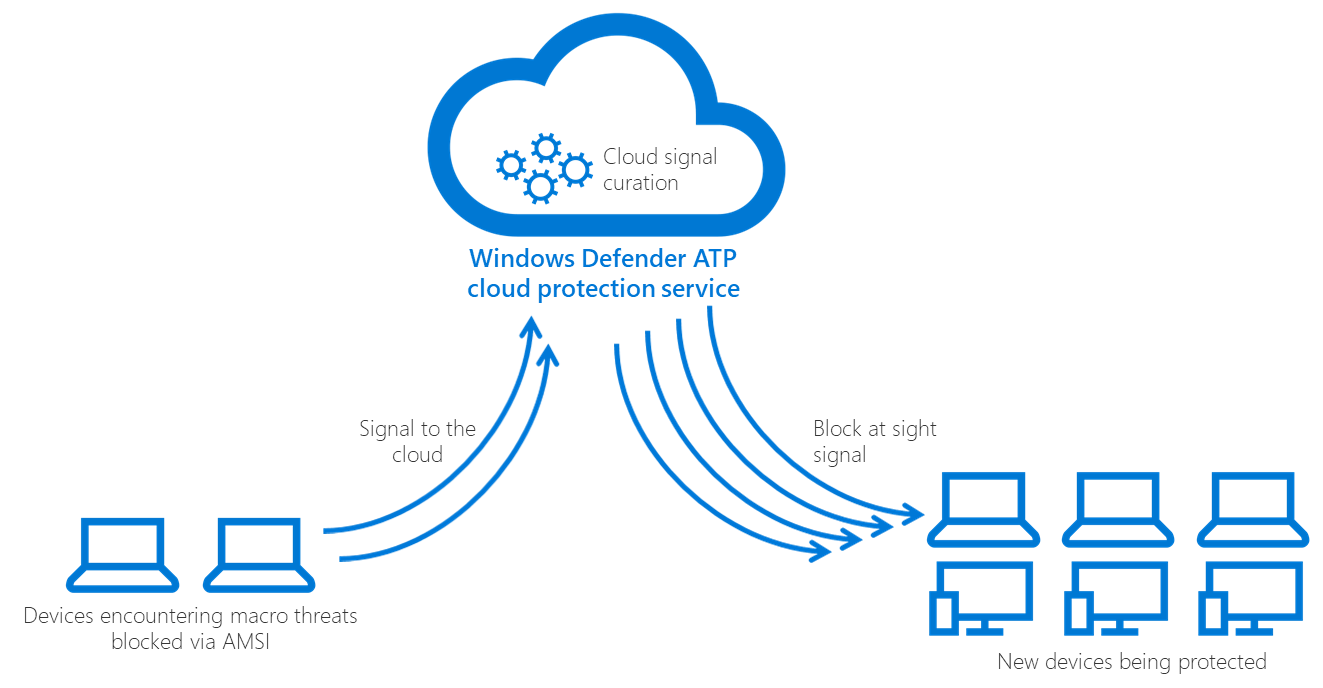

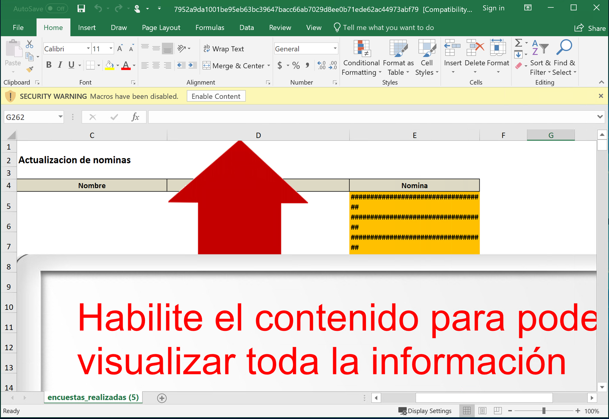

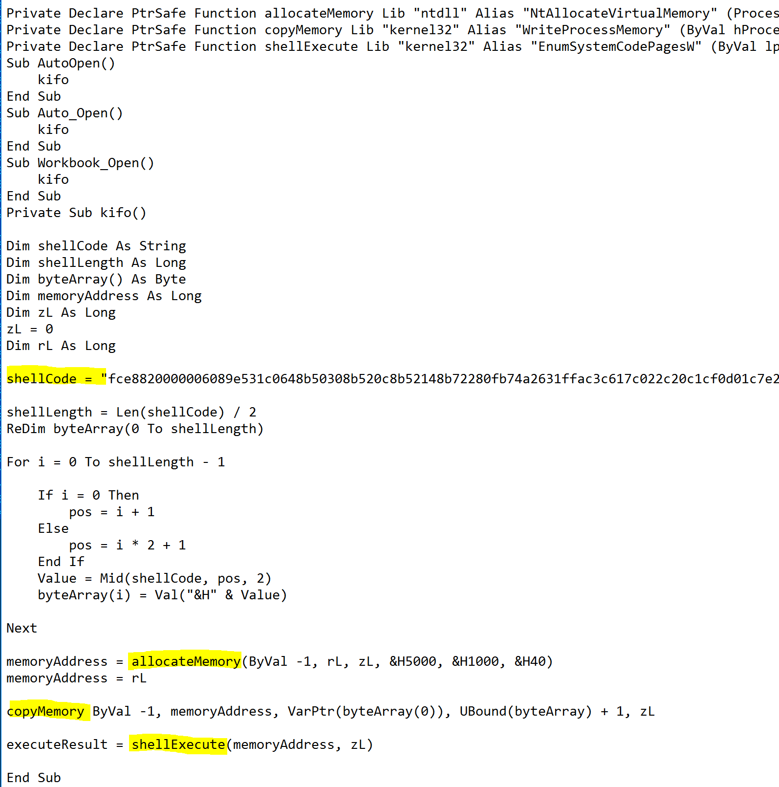

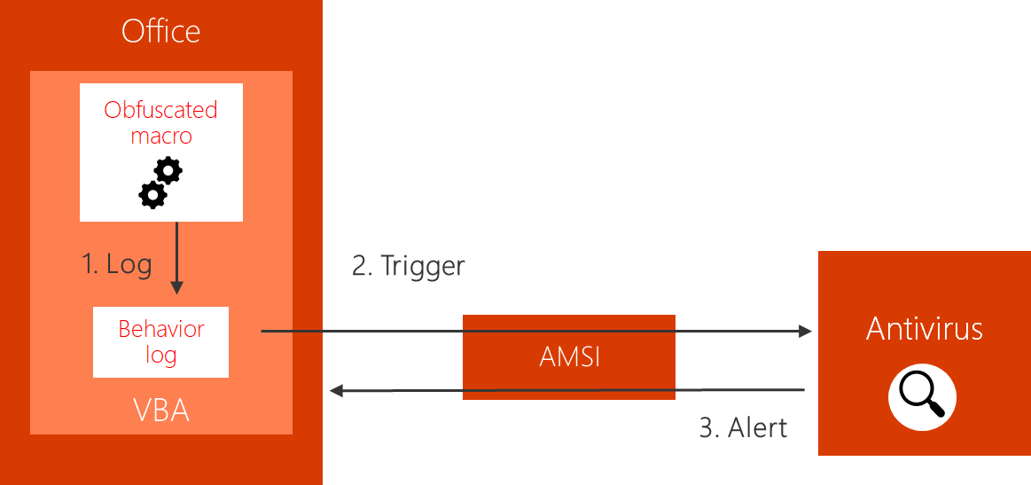

    Office VBA + AMSI: Parting the veil on malicious macros
    Source: Office VBA + AMSI: Parting the veil on malicious macros - Microsoft Secure
