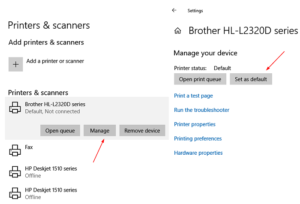

Discus and support How to set the Default Printer in Windows 10 in Windows 10 News to solve the problem; [ATTACH]When using a laptop for both Office and home, we often have to switch printers. Windows 10 doesn’t offer an easy way to switch printer, […]... Discussion in 'Windows 10 News' started by WinClub, Apr 4, 2020.

    I suggest you to follow the below steps to change the printer settings and check if it helps.
    • In the search box, type as “settings”.
    • Go to “settings” and select “devices”.
    • Click on “printers and scanners” option on the left hand side.
    • You will find all your printers listed on the screen, below that there is an option
      “Let Windows manage my default printer”.
    • I suggest you to turn “OFF” the option “When turned on, the default printer is the last used printer”.
    • Now check whether you can choose the other printers or not.
    Hope this information is helpful and do let us know if you need further assistance. We will be glad to assist.
