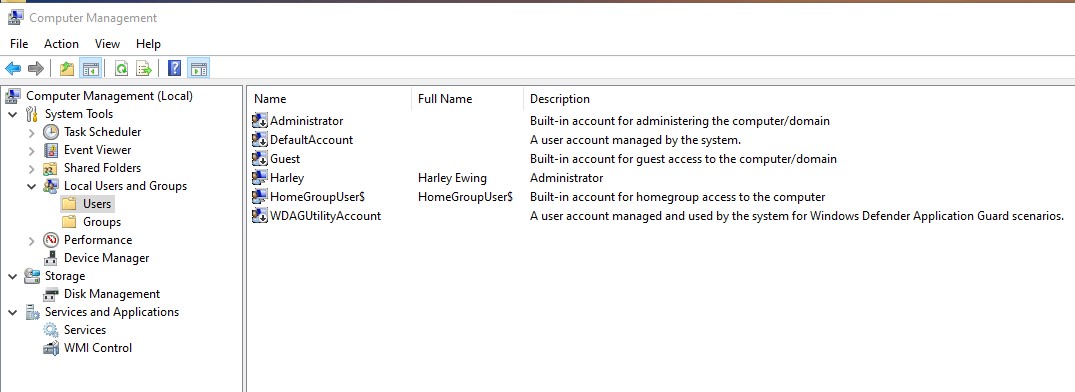

    My computer was acting a little strange so I tried a reboot. Now it won't start up at all and gave out this error 0xc000000e. I had an old 8.0 win disc and installed that to get it going and updated to Win 10. Which runs great now but there are still problems. I am an administrator but can't do anything as an administrator.
    How to Solve Windows Error Code 0xc000000e in Windows 10. [​IMG]
    How to Solve Windows Error Code 0xc000000e in Windows 10. de2c33fd-7a64-4ddb-b115-50e943ea629a?upload=true.jpg
    Anyone know whats going on here? Had system images that failed also.
