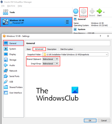

    How to transfer files between Virtual Machine and Host Computer transfer-files-VM-and-host-computer-1-452x500.png
    By default, the Virtual Machine is set to disable. You have to change this setting to bidirectional. The following steps will help you do this.
    1. Launch VirtualBox and select the operating system for which you want to enable the bidirectional file transfer option.
    2. Click on the ‘Settings‘ button. A new window will open.
    3. Select ‘General‘ on the left side.
    4. Under the ‘Advanced‘ tab, select ‘Bidirectional‘ from the drop-down menu in Shared Clipboard and Drag n Drop options.
    5. Click OK to save the settings.

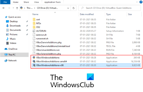

    How to transfer files between Virtual Machine and Host Computer transfer-files-VM-and-host-computer-2.png
    Follow the below-listed steps:
    1. In the Virtual Machine, go to ‘Devices > Insert Guest Additions CD image.’
    2. Open the File Explorer in VM and go to This PC.
    3. Open ‘CD Drive (D): VirtualBox Guest Additions.’
    4. You will find three installation files. First, try to install ‘VBoxWindowsAdditions-amd64.’ If this Guest Addition does not install on your computer, try installing another one. The installation of the Guest Additions depends on the architecture of the host computer.
    5. After the installation gets completed, reboot the Virtual Machine and check whether you are able to transfer the files bidirectionally or not.
    In my case, the copy and paste was working only for the text and not for file transfer. But, I was able to transfer the files by the drag n drop method.
