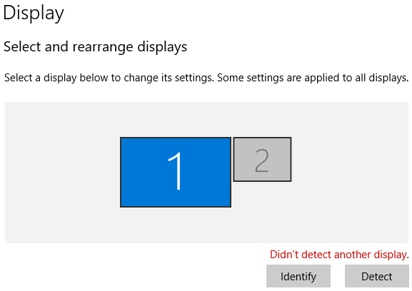

    I know this topic comes up often but I've read through them all and this specific issue does not appear on this forum anywhere, it pertains to the computer model in the title. For the record, this issue is for an employer-issued PC and I would never spend my money on any HP products. I was reading an email on my laptop, which is connected to a docking station, which is connected to two monitors. Without me touching anything, the second monitor suddenly shut off. I checked the display settings:
    HP Elitebook 840 G5 Can Only Use One Monitor at a Time via Docking Station 21021dbc-cc68-4077-8afc-ba840eae8cc4?upload=true.png

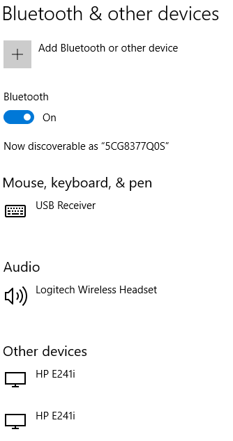

    *** So it says it cannot detect the display anymore. Then I tried to re-add it as a device, here's the Devices screen:
    HP Elitebook 840 G5 Can Only Use One Monitor at a Time via Docking Station 2018d627-8ae3-4012-bc81-30ec74bd60e3?upload=true.png
    And there are my two monitors, already there... So my issue is that I can't add the monitor as a device because the Devices screen says it is already connected, but I can't get the monitor to work because the Display Settings screen says the monitor is not there.
    Another strange detail: when I unplug the monitor that is working, the second monitor turns back on and becomes my main screen. This leads me to believe that it is not a problem with the cable or the monitor or any of the hardware for that matter? Has anyone ever seen this odd behavior before?
    Any ideas would be much appreciated.

    The issue might be due to the display driver or due to improper connection.
    Windows can automatically detect one additional display. If you connect two or more monitors, you must manually designate the primary display, and apply display settings. So, when you connect it the next time, Windows will identify the primary display and
    applies the settings specified for each additional display.
    You can try the below steps and check:
    Update the display driver and check:
    Refer this article on
    Update drivers in Windows 10
    You can also update the graphics driver from the
    HP website
    for the product that you are using.
    I would also suggest you to download and run the
    HP Support Assistant
    . This will provide support for updating and managing the device firmware on the system.
    Unplug the external monitors and try the below steps
    1. Power off the laptop, and connect the first monitor.
    2. Power on the external monitor first, and then the laptop.
    3. Press Windows key + P together, and select Extend.
    4. Power off the laptop, and connect the second monitor.
    5. Power on the external monitors, and then the laptop.
    6. Press Windows key + P together, and select Extend.
    Take your time to try the suggestions and let us know the results at your earlier convenience.
