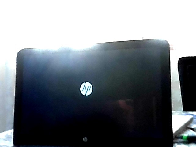

    HP LOGO ONLY
    Anyone please help me i just booted my lap with bootable usbwin10.its stuck at hp logo.Please help me HP LOGO ONLY 0df4698b-514a-4045-8293-b470c691d73f?upload=true.jpg

    Hp laptop screen won’t display except occasionally
    - this suggests BIOS corruption or a hardware problem...
    Whilst you might try flashing the BIOS (updating it may be necessary to run Win 10- witness your problem above), you also say you have access to it.
    Do you hear any beeps or sounds?
    Try steps 1,2 here:
    Laptop freezes at HP logo without loading circle - HP Support Forum - 5997641
    Check the version of your BIOS vs that listed on HP's site for your laptop.
    I'm also wondering if this might be related to your CMOS battery inside your laptop. (This should be a normal circular battery).
    How to replace the CMOS battery
    - but that's just a thought.
    Worth asking on the HP forum.
    Sorry that's not how to create a bootable disk. All that disk is is data storage- as you just copied the files to it.
    Please see:
    How to Create a Bootable DOS USB Drive
    for one way to do it using a free program.
    However, given the above, doing that isn't likely to help you I'm afraid.
